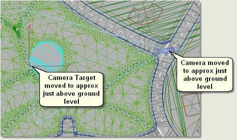

- In the Top viewport create a Target Camera with the target facing the centre of the site
- Move the target to approximately ground level and the Camera, again, to approximately ground level in the position shown below

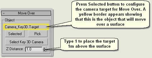

- Open Key 3D Move Over
and press Selected. The name Camera_Key3D.Target appears under Object and a yellow border displays that this is the object that will move over the surface
- Change the Z Distance to 1. This places the camera target 1m above the surface

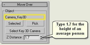

- Repeat this process for the Key 3D Camera

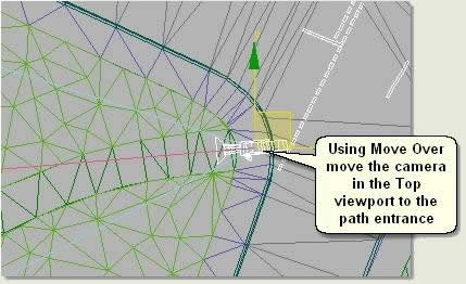

- In the Top viewport move the Key 3D Camera to the path entrance

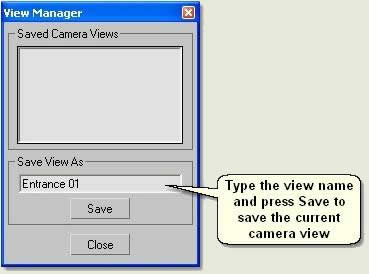

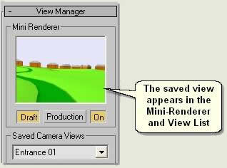

- Open Key 3D View Manager
- Press Save Camera View. In the Save View dialog type Entrance 01 and then Save
- The view appears in the Mini-Renderer and View list
- Repeat the above procedure for all the entrance points so that 4 named views are created
- Finally, move the camera target to the centre of the site - where the small play area meets the path - and move the camera up to give an overview of the site
- Create 4 more views named Overview SW, Overview SE, Overview NW and Overview NE to make 8 views in all

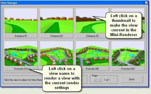

- Press Browser to open the View Manager Browser
- Left click on a view name to render the view with the current render settings
- Left click on a thumbnail to make the view current in the Mini-Renderer
- To change the view in the viewport to the same as the Mini-Renderer press Copy to Camera
