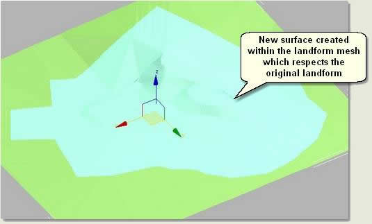

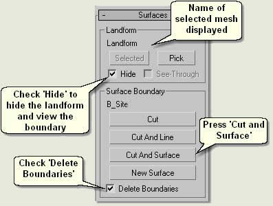

- Select the Landform and open Key 3D Surfaces
- Press Selected to display the name Landform under 'Landform' on the interface. This is the landform mesh from which to cut and create a new surfaces
- Check Hide if the boundary lines are difficult to view under the landform
- In the viewport select the site boundary: B_Site. The name will then automatically appear under 'Surface Boundary'
- Check Delete Boundaries. This deletes the boundary after the surface is created
- Finally, press Cut and Surface. This cuts the landform and creates a new surface within the mesh called B_Site.01 Surface

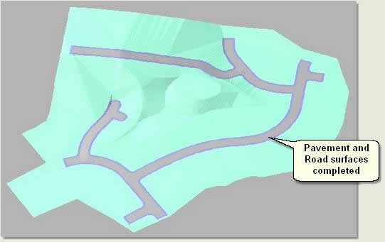

- Repeat this process, selecting the Surface_B_Site as the landform. Select all four pavement boundaries and press Cut and Surface. This automatically cuts and surfaces the pavement surfaces in turn
- When completed, check that the surfaces are good and Attach the pavement surfaces together
- Change the colour if required
- Next, Cut and Surface the Road in the same way

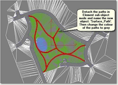

Finally, create independant path surfaces thus:
- Select Surface_B_Site
- In Element sub-object mode select the inner paths and detach these faces. Name the detached surface mesh: Surface_Paths
- Exit sub-object mode and change the colour of the paths to grey

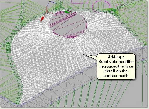

- Select one of the grass surfaces and notice it comprises long thin faces. This because the Terrain object simply 'joins the dots' on the boundary spline
NOTE: The addition of contour data (within the 3D spline areas) when producing the 3D spline model puts extra design detail where required and helps to reduce this 'embankment' effect
- Apply a Subdivide modifier and reduce the Size amount carefully using the spinner until the face detail is increased dramatically
TIP: If the Size is reduced to 0 the computer will 'hang'. To correct this press Esc. To carry on, change the Update setting back to Automatic

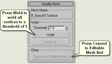

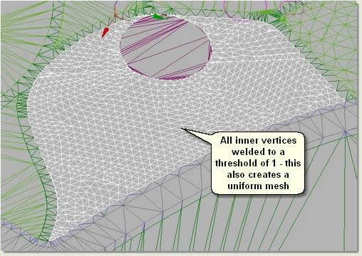

- Open Key 3D Surfaces dropdown menu > Key 3D Simplify Mesh
- Keep the surface mesh selected and press Convert to Editable Mesh
- Type 1 in the Weld Threshold spinner and Weld. All the vertices apart from vertices at the edge of the mesh are welded to a threshold of 1 (ie any vertices less than 1m apart are welded

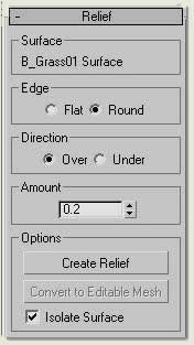

Add Relief

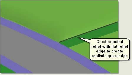

- Select the surface mesh and open Key 3D Relief
- Under Edge select Round
- Under Direction keep on default Over
- Type 0.2 in the Amount spinner
- Press Create Relief. This moves the mesh up 0.2m, but leaves the edges where they were

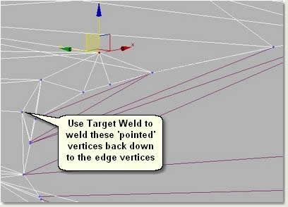

- Notice that on some sections the mesh vertices which are near to the edge have been moved up vertically creating an almost vertical pointed edge. Use Target Weld to move and auto-weld the offending 'points' back down to the edge vertices
- Use Key 3D Relief again, but this time choose Flat and Over with Amount 0.1. This raises the mesh up again, but gives flat relief to represent a cut grass edge
- Weld and Target Weld any stray vertices

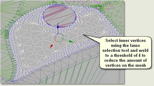

- Finally select vertices in the middle of the grass mesh ie away from the edge and weld vertices to a threhold of 4

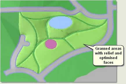

- Repeat this process on the remaining grass areas to produce optimised meshes with rounded relief and flat relief edges simulating grassed areas

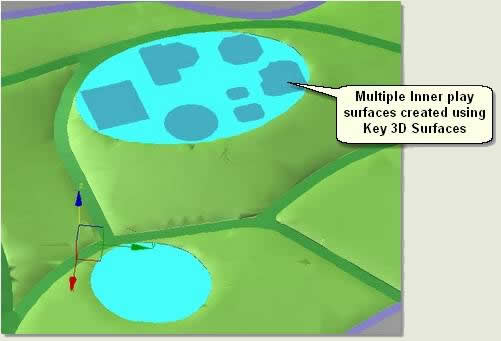

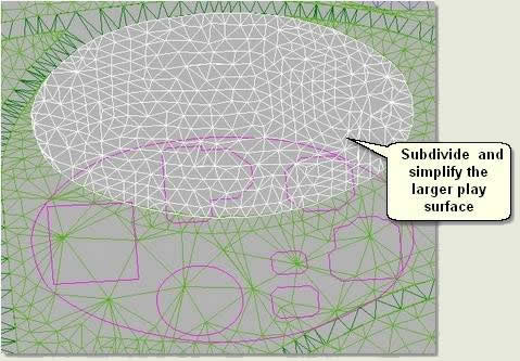

3.3 Create Play surfaces
- Subdive and simplify the larger play surface

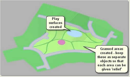

- Cut and Surface the play area using the remaining play surface boundaries. Using Key 3D Surfaces select all the boundaries at once before using Cut and Surface
- Finally, change the display colours of the play surfaces and group all play surfaces together
- Select Surface_ B_Grass01 and Attach all the remaining grass surfaces to create one object. The scene should now contain the following objects (plus the context surface which is hidden):
