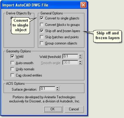

- File > Import. Choose Files of Type: AutoCAD(*.DWG, .DXF) and select Project for 3D 03.dwg
- On the AutoCAD DWG/DXF Import dialog > Layers Tab check Select from list and tick all the layers prefixed with 'B_'. These are all the boundary layers
- On the Geometry Tab > Derive AutoCAD Primitives by > Layer is selected and just Weld is checked to a threshold of 0.1
- Press Ok to import the boundary lines

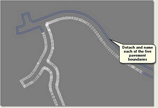

2.2 Detach pavement boundaries
- Select B_Pavement
- Isolate Selection
- In Spline sub-object mode select each spline and detach, renaming the detached splines B_Pavement 01, B_Pavement 02 etc
- Exit sub-object mode
- Exit Isolate Selection

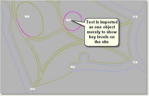

Import level text
- Keep in the current scene or open ACAD to 3D Stage 2a.max
- Open AutoCAD and Project for 3D 03.dwg
- Turn Off all layers except G_Levels
- Save the drawing
- In MAX/VIZ use the Legacy AutoCAD Import dialog to import the text (using Merge on the first dialog) and use the following settings:

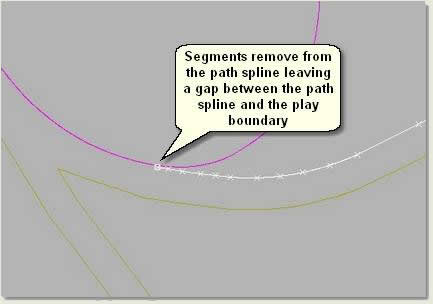

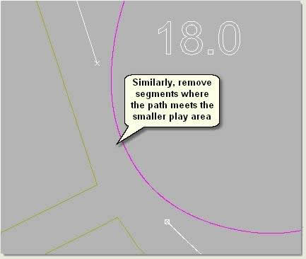

Remove segments not needed to form the landform mesh and move 'flat' area boundaries to the correct level
- Remove segments from splines that overlap other splines, for instance where the play areas touch the paths. Remove segments from the grass boundaries in segment sub-object mode

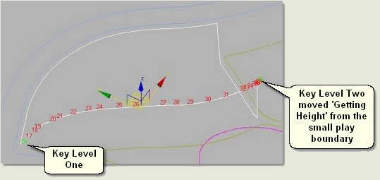

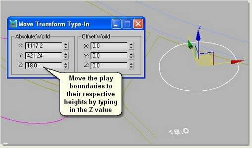

- Maximise the User viewport and move 3Dspline_Play01 and 3Dspline_Play02 to the height shown on the level text within the boundaries

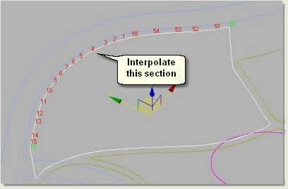

Interpolate the Road spline

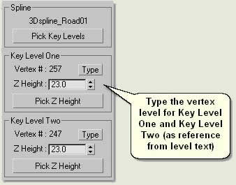

- In the User viewport select 3Dspline_Road01 and open Key 3D Interpolator
- Under Options make sure Turn Snaps On/Off and Display Snap Settings are checked

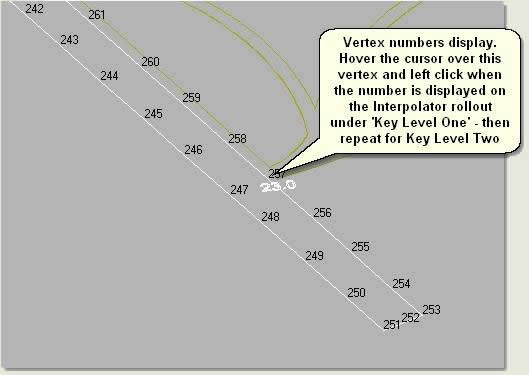

- Press Pick Key Levels. Vertex numbers will display and the Snaps Settings dialog appears
- Just check Vertex and close the dialog
NOTE: Display Snap Settings can be unchecked once this has been set

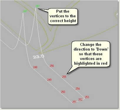

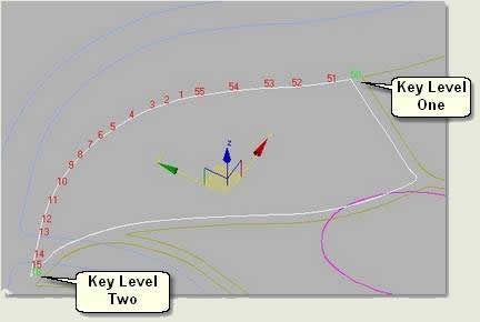

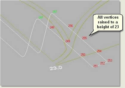

- Zoom to the area of road shown below and hover the cursor over vertex 257 (this may be different depending on the number of vertices added). Look at the Interpolator rollout whilst doing this and when 257 appears under Key Level One left click. The level is then entered and Interpolator is ready to enter Key Level Two
- Hover the cursor over vertex 247 (again this will differ from the example shown) and left click when displayed under Key Level Two.
When Key Level Two is recorded then the buttons on Interpolator become active. Also, the numbers for the key levels turn green in the viewport and vertex numbers to be interpolated turn red. Only the vertices on one side of the key levels are displayed in red - these are the vertices marked for interpolation
- Type in the level of each vertex. In this case both levels are 23
The Key Level vertices jump to their correct heights:
- Practice changing the direction Up or Down before leaving the direction on Down as shown
- Press Interpolate - this interpolates all vertices between the key levels. In this case, all levels are moved to a height of 23
- Press Pick Key Levels again to repeat the process for the next section of spline
- Change the direction Up or Down as required, then press Interpolate

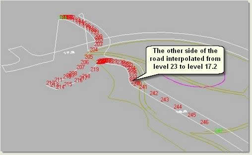

- Repeat this procedure on the other side of the road as shown below

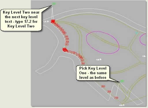

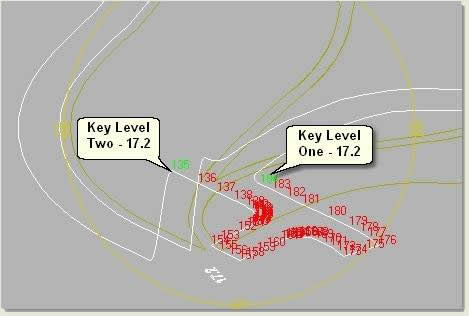

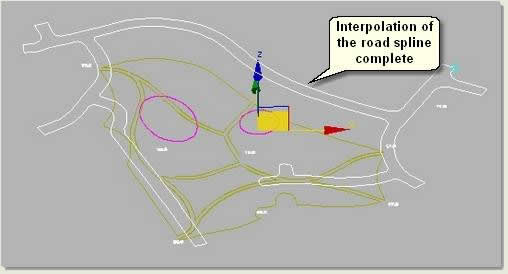

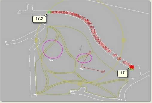

- Interpolate the next section which is flat at a height of 17.2

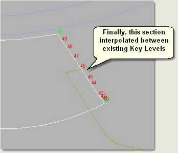

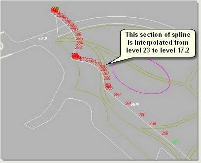

- Interpolate the next section (both sides) from 17.2 to 17
- Complete the interpolation of the road spline as above using the level text as reference

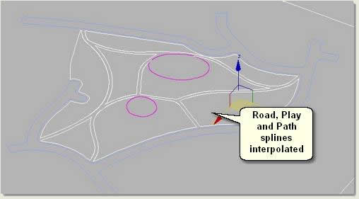

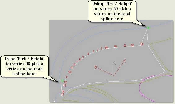

Interpolate the path slines

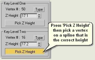

The path splines are interpolated similarly, however levels can be automatically picked up from other splines that have been interpolated (road spline or other interpolated path splines) or put to height (play area flat boundaries). This will speed the process up as you interpolate more splines
- Select the spline shown on the image below
- Select key levels as shown
- Repeat the process for all path splines, checking with 'Arc Rotate Selected' that the lines represent smooth and accurate path edges
- Finally, attach the path splines to create one editable spline and delete the level text

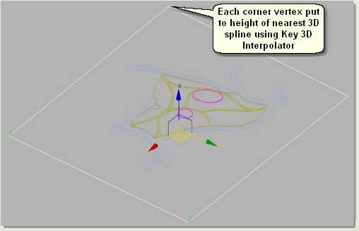

Interpolate the Context Spline
The site needs a context landform. This stops the site 'floating' in mid air and is useful to apply aerial imagery or other context data
- Interpolate the Context spline using Key 3D Interpolator - Use Get Z Height buttons to get height of vertices on the nearest 3D splines. Although no height data is available in this case, this will give an approximation of height

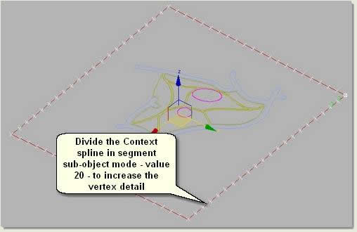

- To complete the 3D spline model divide the Context spline in segment sub-object mode to give more vertex detail

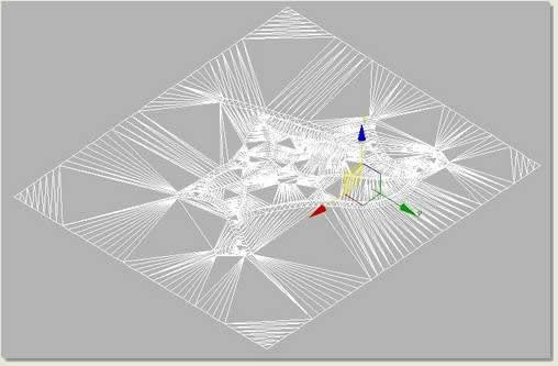

Create a Terrain
- Attach all the splines together
- Finally create a Terrain object from the splines: Key 3D Surfaces dropdown menu > Terrain
TIP: To view the terrain and validate the road, path and play surfaces use the Facets + Highlights display mode
- Finally, convert the Terrain to an Editable mesh (select, right click and 'Convert to Editable Mesh') and rename Landform
