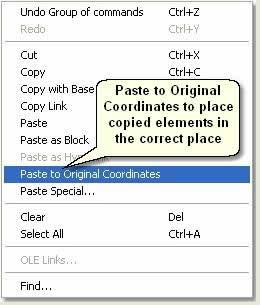

  • In a new drawing Edit > Paste to Original Coordinates. This will automatically paste the drawing elements in the correct place in world coordinates
  • Name the new drawing 'xxxxx for 3D' to identify it as the buffer drawing to import the AutoCAD data into MAX/VIZ. The drawing used in this tutorial is called 'Project for 3D'

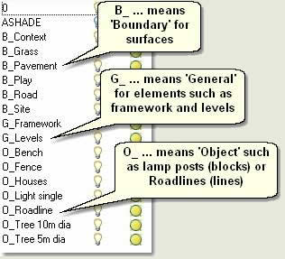

1.3 Layer management
  • Open Project for 3D 03.dwg
  • Look at the layers. They have been named so that anybody (the acid test) can recognise any elements when importing to MAX/VIZ
TIP: Use a template drawing with predefined layers and blocks to speed up this process
NOTE: The 'G_Framework' layer is used to help create surface boundaries using the Boundary command

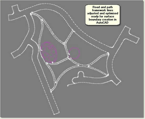

Road framework line optimisation
Road corners
  • Select Layer:G_Framework

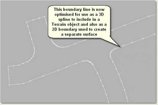

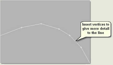

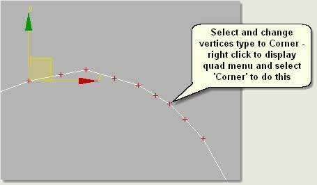

  • Enter vertex sub-object mode and zoom to one of the rounded corners at a road junction

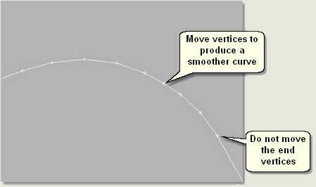

  • Use Refine on the Geometry rollout to insert vertices between existing vertices where needed with a view to creating a smoother and more uniform curve
  • Select all the vertices on the curved section and change to Corner vertices
  • Move vertices to create a smoother corner, without moving the end vertices on the corner
NOTE: In this instance vertices should be added. However, some imported lines may need vertices removing if there are too many. In general, use Corner type vertices whenever possible and adjust the level of detail to suit the proximity of final viewing

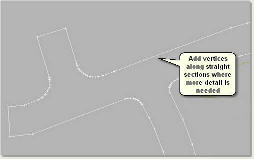

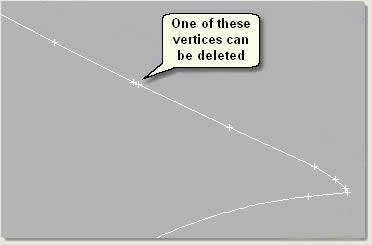

  • On the straight sections add vertices at uniform intervals where there are pronounced lack of vertices. This will lead to a more uniform terrain at the end of the landform mesh creation process
TIP: On longer sections where vertices need adding use the Divide tool in segment mode to quickly add uniform vertices
TIP: Be careful when selecting vertices and turning them to corner type. If you turn bezier type vertices to corner type on sections of the line that have not had vertices added then you will lose the intended geometry of the line (ie the line will not be 'anchored' with new vertices as intended). If this happens use Undo and re-select the line
  • Delete unnecessary vertices:

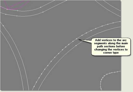

Main path framework lines
  • Add vertices to the splines at regular intervals before turning the vertices to corner type vertices

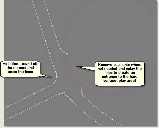

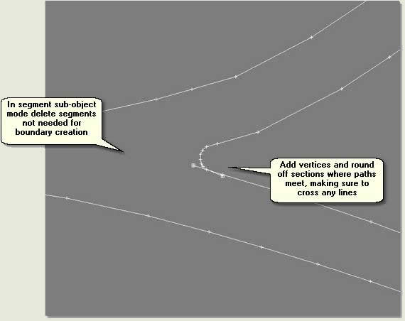

Intersections
  • Where one path meets another delete any spline segments not needed for boundary creation
  • Add vertices where needed and move vertices to round off the path lines, remembering to cross any lines. These will be used to create closed boundaries for the grassed areas in AutoCAD and should have no gaps

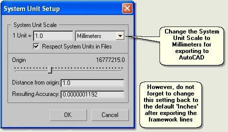

  • Finally, and when confident the geometry on the framework lines has been optimised effectively, export the framework lines back to AutoCAD:
Firstly, change the System Unit Setup settings to millimeters:
  • Customize > Units Setup > System Unit Setup button. Change the System Unit Scale to Millimeters. This will make the exported geometry the correct size when inserted into the project drawing
Then export the framework lines to AutoCAD:
  • File > Export Selected. In the Save File to Export dialog choose Save as type: AutoCAD(*.DWG)
  • Name the file Framework lines optimised.dwg and save in your training files folder
  • Save the scene as Framework.max in case it is needed later
  • When finished exporting change the System Unit Scale back to the default Inches

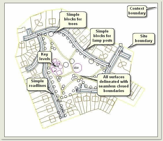

1.5 Create seamless closed boundaries for surfaces

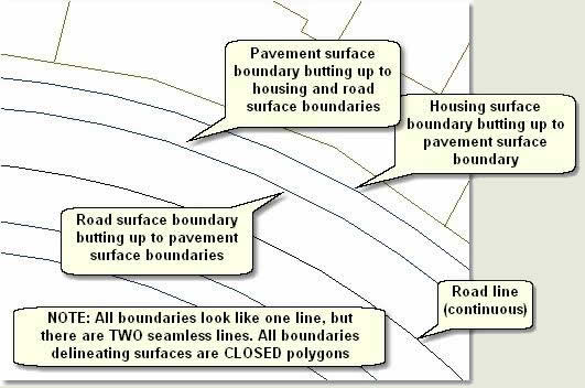

All boundaries for 3D surface creation must be drawn in AutoCAD as closed boundary polygons that have been created using accurate geometrical drawing techniques. This process has been aided by adding a framework layer that has been edited and optimised in MAX/VIZ. The Boundary command is now used in AutoCAD to create the surface boundaries and to make sure that all the boundaries are seamless
NOTE: Double lines delineating a kerb in the 2D plan are not imported into MAX/VIZ, just the seamless boundaries of one surface next to another. Kerbs are created entirely in MAX/VIZ by using the Key 3D Edging routines, involving the use of the Loft compound object. In MAX/VIZ the 3D kerb will extend over the 3D road surface which will be lowered about 150mm (as it is in real-world). Because the kerb will extend over the road it is the back of kerb line that is used for the road boundary

Create surface boundaries

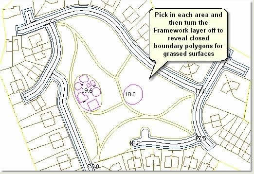

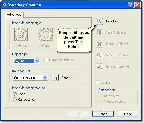

  • Turn the Framework layer on and make the B_Grass layer current (B_ prefix means that this is a surface boundary)
  • Draw > Boundary. On the Boundary Creation dialog press the Pick Points button and pick in each grassed area to create a boundary on the current layer
  • Save the drawing as Project for 3D 03 tutorial.dwg for your own use and do not overwrite Project for 3D 03.dwg
NOTE: A site boundary has been created on layer B_Site. This is used to create a site surface, thus separating the design surfaces from the context surface (which will be far less detailed)
NOTE: An advantage of creating surface boundaries using the Boundary command is that they do not contain 'intersecting vertices' (a common problem in 3D modelling work). Creating boundaries in this way also ensures that the polygons are completely closed. Closed boundaries are also useful in AutoCAD for hatching, obtaining area quantities and export to other 3rd party applications such as Corel Draw and Adobe Illustrator

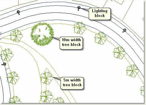

1.6 Replace detailed blocks with simple blocks for MAX/VIZ/Key 3D
Complicated 2D blocks should not be imported into MAX/VIZ if they are merely used as markers for 3D Objects or, as in this case, for replacing with 3D objects. Replacing blocks with much simpler blocks before importing into MAX/VIZ is straightforward in AutoCAD using the Block Editor. This exercise explains how this was done in the tutorial project drawings
  • In AutoCAD open Simplify Blocks.dwg. The drawing contains two complicated graphic blocks for trees and one lighting block. These have been used as part of the design production drawing, but the blocks are too detailed for import into MAX/VIZ

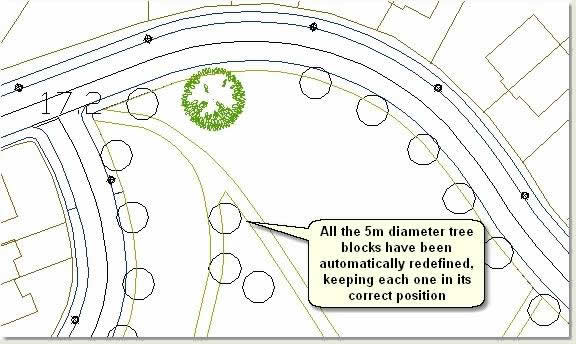

Redefine the tree blocks

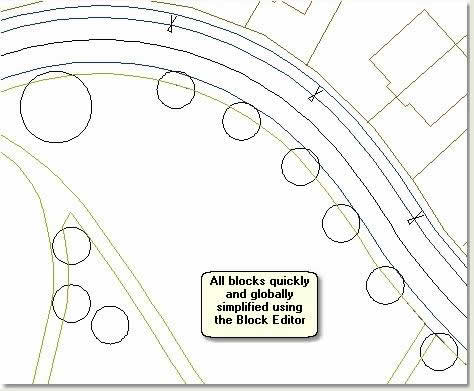

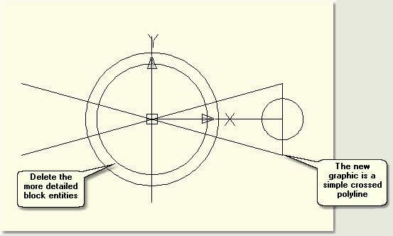

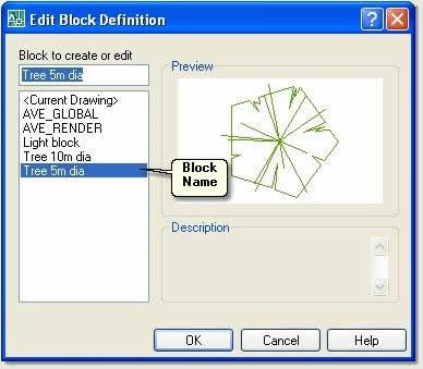

  • Select one of the 5m tree blocks and double left click. This opens the Edit Block Definition dialog
NOTE: The Edit Block Definition dialog is a feature of AutoCAD 2007 plus. Replacing blocks in previous versions of AutoCAD entails using the Reference Edit dialog or simply 'redefining blocks'
  • Press Ok to open the block up for editing in the Block Editor

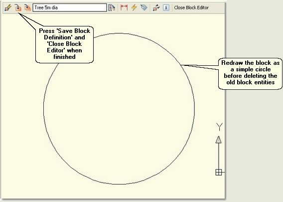

  • In the Block Editor make sure layer O_Tree 5m dia is current
  • Draw a circle from the centre of the existing block, making it the same diameter as the existing block
  • Erase the existing block entities, leaving just the new simple circle
  • Press Save Block Definition on the Block Editor toolbar and close the Block Editor dialog. All of the 5m tree blocks will be automatically redifined
  • Repeat this process to simplify the 10m tree blocks and the lighting columns, making sure that the correct layer is made current in the Block Editor. To simplify the lighting columns use the following graphic:
