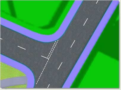

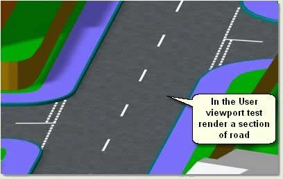

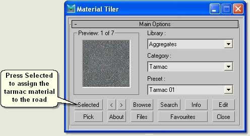

  • Select B_Road Surface

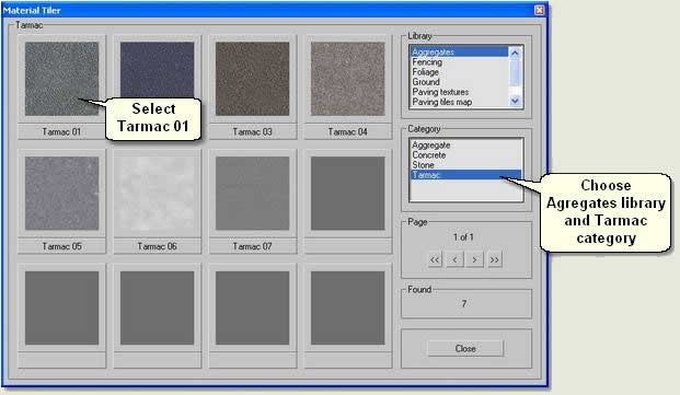

  • Open Key 3D Material Tiler and press Browse
  • Choose Aggregates library and Tarmac category
  • In the User viewport zoom to a section of road and test render to view the results

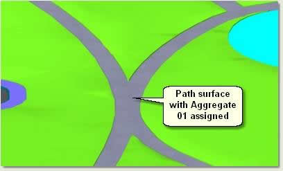

  • Using Key 3D Material Tiler assign Aggregates / Aggregate / Aggregate 01 to the paths surface: Surface Path

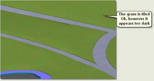

  • Select Surface_B_Grass and assign Ground / Grass / Grass 01 to the grassed areas

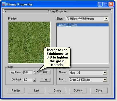

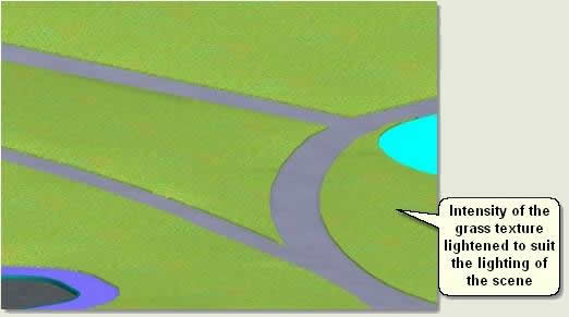

The grass is a little dark and needs to be lightened slightly
  • Keep Surface _B_Grass selected and open Key 3D Bitmap Properties. Change the RGB Level to 0.8. This lightens the intensity of the grass texture to suit the lighting conditions

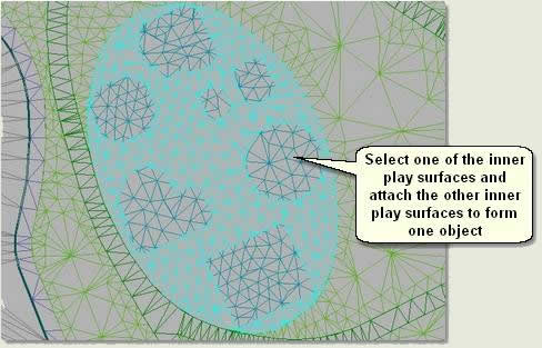

  • In the Top viewport and in Wireframe display mode Attach the inner play surfaces together and rename Inner play surfaces
  • Assign Aggregates / Aggregate / Tarmac 02 to the inner play surfaces. This has a similar texture to rubber safety surfacing

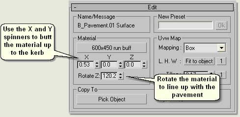

  • Assign Paving tiles map / 600x450 / 600x450 run buff to Surface_B_Pavement
TIP: To make all sections of paving follow the direction of the pavement, split the paving up into sub-surfaces using the Key 3D Surfaces routine and assign a separate paving material to each section, rotating the paving material for each section

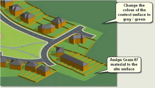

Site surface and Context surface
  • Assign Ground / Grass / Grass 07 to Surface_B_Site
  • Change the colour of Context surface to a darker grey/green

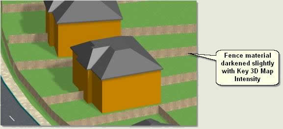

  • Assign Fencing / Wood / Wood 10 to O_Fence
This material will appear too light
  • Use Key 3D Bitmap Properties to reduce the RGB Level to 0.5 (Ref: 8.1)

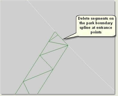

  • Select Site fence path and enter Segment sub-object mode. Delete all segments apart from those on the park boundary. Also delete segments at entrance points on the park boundary spline
  • Again, in Segment sub-object mode delete segments on the park boundary spline at entrance points

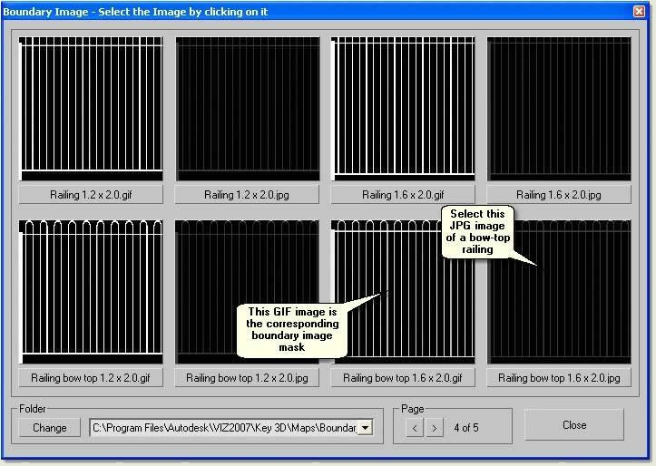

  • Press to open the following sample browser and navigate to page 4
  • Select Railing bow top 1.6 x 2.0.jpg. This must be the JPG file and not the GIF file (this is the image mask)
  • Change the Spacing to 2
  • Change the Height to 1.6
  • Press Apply to create the image bow-top fence at 2m post spacing and 1.6m high

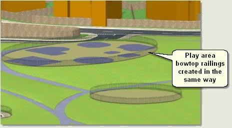

  • Repeat the above routine for the play area fences and name these Small Play Fence and Large Play Fence
NOTE: The play area surfaces need to be ungrouped (or opened) before selecting the larger play area surface. Also, make sure no isolated vertices exist on each surface by using Remove isolated Vertices in vertex sub-object mode

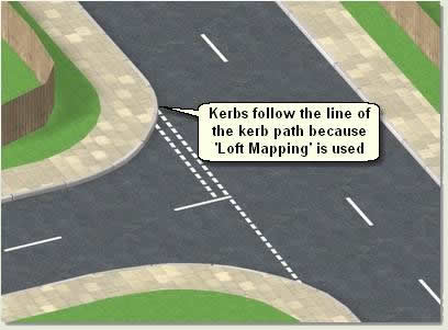

The kerb was created using the MAX/VIZ Loft compound object. This requires the material to follow the loft path, as real-world kerb sections follow the line of the road. The Loft mapping parameters are used to do this
  • Select Loft01 and rename Kerb
  • Zoom to the kerb loft to gain a good view of straight and curved sections
  • Open Key 3D Material Tiler and assign Paving Tiles Map / 450x450 / 450x450 stack grey to the kerb

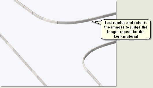

  • On the Modify Panel remove the UVW Map modifier
  • Open the Material Editor and select an empty sample window
  • Use the Pick Material from Object button to pick the kerb's material for editing

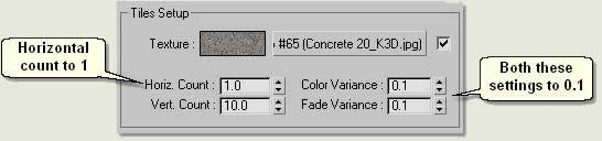

  • Go to the Map level by pressing the Map Button to the right of the Diffuse swatch and open the Advanced Controls rollout of the Tiles material
  • Change the Horizontal Count to 1
  • Change the Color Varience and Fade Varience both to 0.1 and Go to Parent

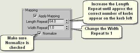

  • In the Modify Panel Loft Surface Parameters change the Surface Parameters > Mapping, whilst viewing the kerb in the viewport and test rendering as below:
  • When satisfied with the kerb mapping convert the loft to an Editable Mesh

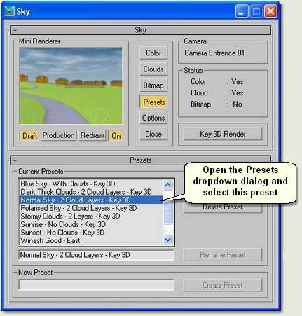

  • Maximise the Camera viewport
  • Open Key 3D View Manager and select View: Entrance 01. Press Copy to Camera

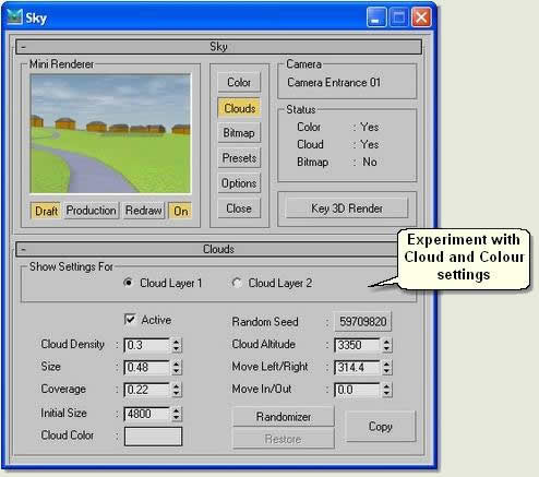

  • Open Key 3D Sky. Press Presets and select Normal Sky - 2 Cloud Layers - Key 3D
The Mini-Renderer displays a small render of the scene via the current view selected in Key 3D View Manager
  • Use the Colour dropdown and Clouds dropdown to change the sky and cloud properties:
TIP: Make the Cloud Layer 2 altitude higher than Cloud Layer 1 and slightly darker. Use subtle Cloud Density so that the sky does not detract from the main scene elements. Use a preset for a good start and tweek settings to get the desired result or press Randomizer to obtain a random start. When happy with a sky solution save it as a preset for future use in any scene
  • Close Key 3D Sky

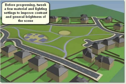

  • Finally, tweek the colour of the Houses by opening the group and selecting all the houses. Also, tweek the Bitmap Properties of the grass (slightly darker) and house fences (slightly darker)
  • Tweek the shadow settings in Key 3D Sunlight and perhaps decrease the Light Dome multiplier to 0.4
