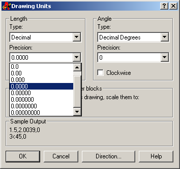

When you start the Units command, the first thing you see is the Drawing Units dialogue box, shown on the right. The dialogue box is divided into four main sections. The upper two are "Length", which refers to linear units and "Angles", referring to angular units. Settings for linear units and angular units can be made independently and in each case, you can control both the type and precision. In addition, the Angles section also allows you to specify the direction in which angles are measured. See below for more details.
A third section, entitled Drawing units for Design Center blocks allows you to assign a specific unit to the drawing so that when blocks are inserted via the AutoCAD Design Centre, they will automatically be scaled. The final section, Sample Output, gives you a preview of the drawing units as they will be displayed using the current settings.
You can see from the dialogue box that there are five different linear unit types for you to choose from, one of which is "Decimal", the default. The table below shows the effect of the different unit settings on two drawing unit values to give you an idea how the various settings might be used along with a brief description.

The Drawing Units dialogue box can also be used to set the precision of linear and angular units. By default, AutoCAD sets the linear unit precision to four places of decimal, so distances appear in the form 0.0000. Angular unit precision is set to whole degrees only.
To change the precision with which linear and angular values are displayed, simply click the down arrow against the appropriate drop-down list (see illustration on the left) and select the number of decimal places required. The default setting of four decimal places is usually adequate for linear units. It is, however, often necessary to change the precision for angular units. Working in whole degrees does not usually give an adequate level of detail for many drawing functions. However, you do not need to change the precision of either linear or angular units unless you have a specific reason for doing so.
Changing the unit precision does not make your drawing more accurate, it just means that the co-ordinate display on the status bar and the results from the various inquiry commands will be displayed with a higher degree of precision. The accuracy of your drawing will be determined by the values you enter for the size of objects when you draw and edit them and by the correct use of the various object snaps and drawing aids. See the appropriate tutorials for more details.
