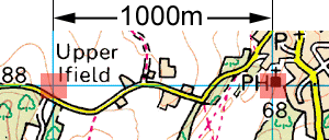

Grid Intersections The Scale command has an option that can be used to scale an object simply by reference to two pick points and a known true distance. It works in a similar way to the method described above except that AutoCAD automatically measures the distance and calculates the scale factor for you. For this exercise, we will use the two upper grid intersections as the pick points and the true distance between them (1000 metres).

Specify scale factor or [Reference]: R
Specify reference length <1>: (zoom in Zoom Window and pick the point where the grid lines cross)
Specify second point: (zoom out Zoom Previous and then zoom in Zoom Window on the second grid intersection and pick the point)
Specify new length: 1000
Pick Left Pick Right
Zoom in and pick first point Zoom in and pick second point
Obviously you cannot use the Object Snaps to accurately pick points on a raster image. The only way to achieve a reasonable accuracy is to zoom in as far as possible and pick as precisely as you can. As you can see from the illustrations above, this is not always easy, the closer you get to a raster image line, the wider it becomes. This is not ideal but you should be able to achieve accuracy to within a fraction of one percent which is acceptable for most purposes.
Finally, zoom extents Zoom Extents to display the full image. The Map Image is now correctly scaled in metres. You can always check this by using the Distance command Distance to pick the same two points. You should see that the distance is 1000 drawing units (or thereabouts, depending upon the accuracy of your pick). You can now "trace" over the raster image using all of the usual AutoCAD commands such as Line and Polyline. Any vector drawing objects thus created will be correctly scaled in metres.
