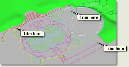

- Trim faces from the walls and other surfaces using face sub-object mode

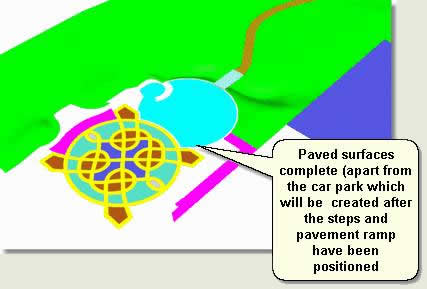

Paved Areas
The paved areas are created by turning some boundary splines into editable meshes, using the Subdivide modifier to create more faces and using the Shapemerge compound object to cut and surface inner paved areas

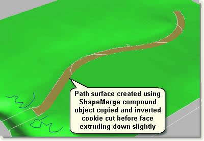

Meadow Path
- Select Meadow surface
- Create a Shapemerge object using the Cookie Cutter option and using Bdy meadow path as the shape
- Copy clone the ShapeMerge object
- Invert the Cookie Cutter option on the copied ShapeMerge object and rename the new ShapeMerge object Meadow path surface
- Convert the meadow surface and path surface to editable meshes and apply a different object colour to the path so that you can readily see it in the viewport
- Select the meadow path
- In face sub-object mode select all faces from the path and apply a Face Extrude modifier
- Extrude to -0.1, then convert to an editable mesh. This give the path some relief below the meadow surface

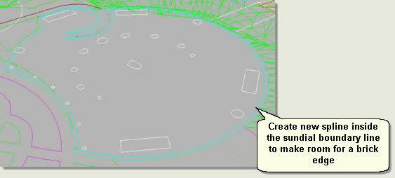

Sundial Surface
- Select Bdy sundial surface and create an outline in spline sub-object mode of 0.2m
- Detach the new spline and rename Sundial surface
![](/tutorials/3ds-max/surfaces/surfaces 010.jpg)
If this is now converted to an editable mesh the operation will fail. This is because the outline operation produces intersecting vertices. To correct this situation the vertices must be welded thus:

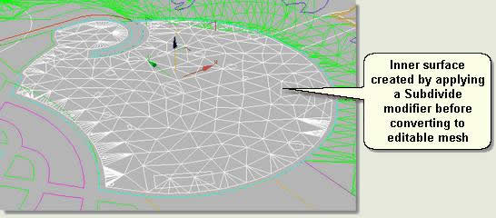

- Select Sundial surface spline
- In Vertex sub-object mode select all vertices and Weld, keeping the threshold at 0.1. Exit sub-object mode
- Utilities Panel > More > Shape Check - Press Pick Object and pick the spline. This displays ‘Shape Ok’ if there are no intersecting vertices and ‘Shape Self-intersects’ if there are further problems. If so, zoom to where the red box markers are positioned on the spline and either weld these vertices again or delete the problem vertices
- Apply a Subdivide modifier and enter a value of 1. This divides the surface into more equal faces and stops long thin faces being created
- Convert the surface to editable mesh

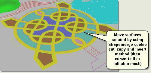

Celtic Maze

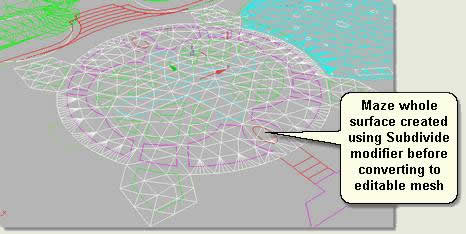

- Select Bdy maze whole
- Apply a Subdivide modifier, value 1 and convert to editable mesh
![](/tutorials/3ds-max/surfaces/surfaces 014.jpg)
- Use ShapeMerge compound object cookie cutter copy and invert method to create surfaces for Maze inner, Maze outer, Maze mosaic, Flags and Planting beds
![](/tutorials/3ds-max/surfaces/surfaces 016.jpg)
- Create the Flag surface by using the Subdivide modifier and converting to an editable mesh

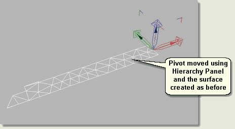

- Select Bdy pavement ramp
- Isolate selection
- Snap the pivot to the top of the ramp where it meets the top pavement. This will be rotated down later from this pivot point position
- Create the pavement ramp surface by subdividing and converting to editable mesh
