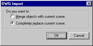

DWG Import Dialogue Box When the DWG Import dialogue box appears, click the "Completely replace current scene" radio button and click the "OK" button to proceed. This effectively creates a new 3D Studio model from your AutoCAD original. The "Merge objects…" option can be used to add AutoCAD drawings to existing 3D Studio models.

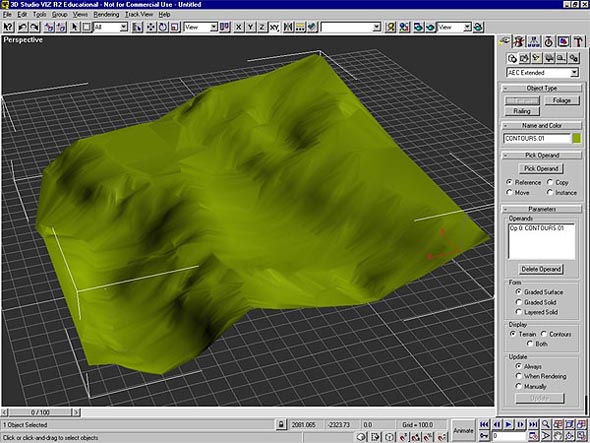

Creating a terrain object with 3D Studio VIZ R2 is a simple, one-step process. Once your contours have been imported, click on them to select them. Since your contours were all on the same AutoCAD drawing layer and since you specified objects to be derived by layer, your contours now form a single 3D Studio object. Clicking on any contour will select the entire set of contours. You should see a white "bounding box" appear around the contour set. AEC ExtendedNotice also that the object name shown in the Control Panel is derived from the layer name. For example, if your contour layer was called "Contours", the contour object will be called "CONTOURS.01".
Click the Create tab Create on the Control Panel if it is not already selected and then click the Geometry Geometry button. Click the arrow on the drop-down list below the Geometry button and select "AEC Extended". The Control Panel should now look like the illustration on the right. If the "Terrain" button is greyed-out, your contour object is not selected. Select the contour object to activate the button. To create the terrain object, simply click the "Terrain" button. In a few moments a triangulated surface will be created.
If the current view of the terrain object is not satisfactory, use the Arc Rotate Selected Arc Rotate Selected, Field-of-View Field-of-View and Pan Pan buttons, located at the bottom right-hand corner of the screen to adjust it. If you are familiar with AutoCAD 2000, you will recognise the Arc Rotate Selected tool as being similar to the 3D Orbit tool. Your computer screen should now look something like the one shown below.

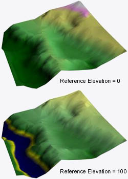

Form and Display There are a couple of terrain parameters that are worth considering at this stage. If you look at the Parameters section of the Control Panel, you should see options under the headings of "Form" and "Display" (see the illustration on the right). The Form options allow you to generate the terrain object as either a Graded Surface (the default), a Graded Solid or as a Layered Solid. The illustration below shows the effects of the various options. 3D Studio treats your original contours and the new triangulated surface as the same object. The Display options enable you to display the terrain only, the contours only or both terrain and contours.
Terrain Options
Once you have completed the terrain creation process, the terrain options disappear from the Create tab on the Control Panel but you can still access the options from the Modify tab Create. In fact, you can access the terrain options at any time by selecting the terrain object and clicking the Modify tab.

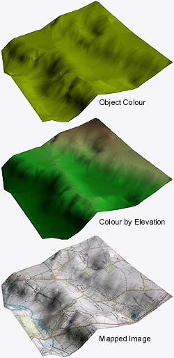

Once you have successfully created a terrain object, you may want to apply a material to improve the quality of the render. There are numerous options but this tutorial considers two that are particularly appropriate for terrain objects. The first option, Colour by Elevation is described in the next section of this tutorial. The second option, Adding an Image Map is described below.

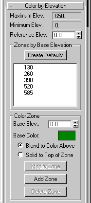

Colour by Elevation To start the Colour by Elevation process, select the terrain object, click the Modify tab Create on the Control Panel and expand the Colour by Elevation rollup by clicking on the button. The button is right at the bottom of the Control Panel and you may have to scroll down to find it. As you can see from the illustration on the right, the Control Panel shows the maximum and minimum elevations (Z values) and the reference elevation. The reference elevation controls where 3DS VIZ places the elevation datum. By default, this value is set to the minimum elevation of the terrain object. However, 3DS VIZ treats terrain elevations below the reference elevation as water and those above as land. Water and LandYou can create instant results by clicking the "Create Defaults" button. The illustrations on the left show the difference between setting the reference elevation to 0 and to 100 and then clicking on Create Defaults. When the reference elevation is set to 100, elevations below 100 are blue in colour, whilst those above are green. Between the two is a thin band of yellow that mimics the effect of a shoreline or beach. When the reference elevation is set to 0, all of the terrain object is considered to be land and base elevations and colours are assigned accordingly. Getting 3DS VIZ to create default settings for you is a good way to start the Colour by Elevation process. However, you will often need to modify the default settings in order to create a more appropriate colour range. Notice that in the illustration above, 3DS VIZ is quite happy to suggest that our terrain object might have a snow capped peak, even if the data is derived from southern England. The next section of the tutorial describes how to modify the colour zones.
Top of page
Modifying Colour Zones
Colour zones are defined by specifying just two parameters, namely, Base Elevation and Base Colour. You also have the option of having the colour blend with the one above. To modify a colour zone, simply highlight it in the "Zones by Base Elevation" list and enter an appropriate base elevation using the "Base Elev" edit box. To change the colour, pick on the "Base Color" box and select an appropriate colour from the Colour Selector dialogue (shown below). The Colour Selector allows you to define a colour using RGB values (Red, Green, Blue), HSL values (Hue, Saturation, Lightness) or simply by picking on any of theColour Selector colour areas. Click the "Close" button on the Colour Selector to assign the chosen colour to the colour zone. When you have entered the base elevation and selected the base colour, decide whether you want the colour to blend with the zone above and pick the appropriate radio button. To apply the new settings, click on the "Modify Zone" button. You should be able to view the changes you have made on the terrain object almost instantly, depending upon the complexity of the object and the speed of your computer.
Blend to Colour AboveTo add a new colour zone to the list, go through the same process as described above but click on the "Add Zone" button. A new colour zone will appear in the list and once again the terrain object will update to show the effect of the new colour zone. You can also delete a zone by highlighting it in the list and then clicking on the "Delete Zone" button. Eventually, you should be able to create a set of colour zones of varying band depths and in various colours that mimics the landform you want to create. The colour zones displayed in the illustration above were created by modifying the default colour zones and adding three Solid to Top of Zonenew ones, a total of eight colour zones in all. In order to give a smooth colour transition between one zone and the next, all zones were set to "Blend to Color Above". To give you an idea of the difference this makes, the illustration on the right uses the same colour zones but with each zone set to "Solid to Top of Zone". As you can see, the zones are more clearly defined, which would be good for an elevation analysis but the effect is less realistic.
You can remove Colour by Elevation from a terrain object by deleting all of the colour zones associated with it. The terrain appearance will the return the the object colour. However, there is now way to restore your colour zones after you have deleted them.

As you have seen above, setting Colour by Elevation can create quite realistic terrain effects. However, you may want to improve upon this by adding an image map to the terrain object. Image maps can be any bitmap image, so you could use an aerial photograph or a cartographic map of the same area. Adding an image map to a terrain object is a relatively simple process with one proviso. The area (of the real world) covered by the contour drawing and the bitmap image must be the same in order that the bitmap is correctly georeferenced with respect to the terrain object. Providing this condition is satisfied, all will be well. The sample file Map-Bit.jpg covers exactly the same area as the drawing file Map-Bit.dwg. In fact, the contours were traced from the bitmap image in AutoCAD. This is a sure-fire way of making sure that the two match up correctly.
Asset Manager
To map the image onto the surface of the terrain object, start by clicking the Utilities tab Utilities on the Control Panel and then click on the "Asset Manager" button. When the Asset Manager appears, use the Explorer style window on the left to navigate your way to the folder where your bitmap image is stored. Clicking on the folder displays all available image files in the folder as thumbnail images in the right hand window. The illustration above shows the Asset Manager with the Map-Bit.jpg file highlighted. You can change the size of the thumbnail images using the Display Thumbnail buttons on the Asset Manager toolbar.
Position the Asset Manager window so that you can see both the required image thumbnail and the terrain object. Drag and drop the image thumbnail onto the terrain object. The terrain object may change colour as the image map is applied but the image does not yet display correctly because the mapping default settings are not designed for this particular effect. If you have assigned Colour by Elevation to the terrain object, the image map may not show in the Perspective window. However, the image map has been assigned and it will display in a render window if the view is rendered. See Rendering, below for details.

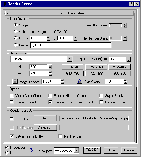

All of the required settings for creating a rendered image of your terrain object can be set using the Render Scene dialogue box, illustrated below. To display the dialogue box, click the Render Scene button Render Scene on the main toolbar. You will need to set a number of options in the Common Parameters rollout.
In the "Time Output" area, click on the "Single" radio button if this is not already selected. This tells 3DS VIZ to render a single frame. As you can see, other options exist which allow you to render an animation. See the Rendering the Animation section of the Walkthrough tutorial for more details.
Render Scene Dialogue Box
You can now use the "Output Size" area of the rollout to specify the size of the rendered image in pixels. You can either set the size manually using the "Width" and "Height" edit boxes or you can use one of the pre-set options by clicking the appropriate button. For the purposes of this exercise, set the size to 320x240 by clicking the "320x240" button.
Render Window Deselect the "Save File" option in the "Render Output" area if it is checked. Finally, make sure that the view you want to render is shown in the "Viewport" drop-down list. If you are following the tutorial, this viewport should be set to "Perspective". To start the render process, click the "Render" button. Two new windows now appear on your screen. The Perspective window displays the rendered image as it is rendered and the Rendering window shows the progress of the render, giving details of time taken. When the render is complete, the Render window disappears but the Perspective window remains so that you can look at the rendered image. If you are following this tutorial and you have applied the image map, your Perspective window should look similar to the one in the illustration above. So far we have created a small rendered image and viewed it on screen. This process is very useful for previewing a render whilst you are working on a drawing. Once you have made the settings in the Render Scene dialogue, you can preview renders as you work on your drawing by clicking on the Quick Render button Quick Render. This by-passes the dialogue and renders using the existing settings. Eventually though, you will probably want to render at a larger size and save the image to a file.
Top of page
Rendering to a File
Rendering to a file requires you to specify a filename, to choose a file format and to make any necessary settings that may be specific to that file format.
Click the Render Scene button Render Scene to display the Render Scene dialogue box. Make the settings as for rendering a view except, click on the "Save File" check box in the "Render Output" area of the rollup. Next, click on the "Files…" button to display the Render Output File dialogue box.

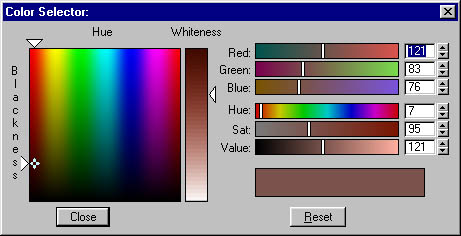

You will probably have noticed that your rendered images all have a black background. This is the default colour for renders. It is, however, very easy to change the colour. The next section of the tutorial deals with this topic.
Top of page
Changing the Background Colour

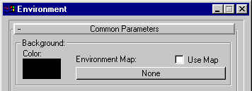

The render background colour is controlled from the Environment dialogue box. To display the Environment dialogue box, select RenderingEnvironment… from the pull-down menu.
Environment Dialogue Box The "Background" area of the "Common Parameters" rollup, shown on the left, displays the current background colour in a rectangular window. Since you have not yet set a colour, this window will be black. To change the background colour, click on the colour window to display the Colour Selector dialogue. Choose a colour from the palette and then click the "Close" button. The new colour now displays in the background colour window. To see the results of your change, render the view.
Changing the colour of the render background is a good way to liven up your rendered images. However, to really give them some punch, try using an environment map.

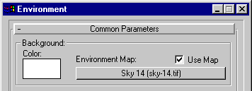

Environment maps are images used as backdrops to rendered views. Almost any bitmap in most of the standard file formats can be used as an environment map. This means that you could even use a photograph of an existing site and use it as a backdrop to show your proposals.
Asset Manager

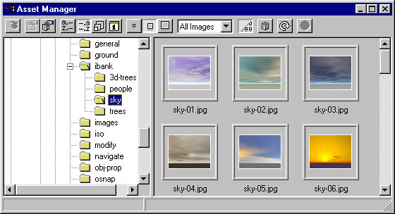

The simplest way to apply an environment map is to first find the image you want to use with the Asset Manager. Click the Utilities tab Utilities on the Control Panel and then click the "Asset Manager" button. Navigate your way to the folder where your images are stored and wait for the image thumbnails to display. Next, open the Environment dialogue box, select RenderingEnvironment… from the pull-down menu. Notice that the Environment Map button currently displays the word "None", meaning that no environment map has been specified.Enter Material Name Dialogue Box To assign an image as an environment map, drag the thumbnail image you want from the Asset Manager and drop it onto the Environment Map button in the Environment dialogue. When you have done this a small dialogue box appears and prompts you to enter a name for the new material you are creating. Enter a name and then click the "OK" button. The Environment Map button in the "Background" area of the Environment dialogue box changes to display the material name and the image file name. You can now close the Asset Manager but keep the Environment dialogue open.
Environment Dialogue Box You have now assigned an environment map and if you render the view you will see your bitmap used as a background image. However, the image has been applied with default mapping settings (spherical environment), which may not be what you want. In order to change environment map settings, you must first drop your new material into the Material Editor.
Click on the Material Editor button Render Scene to display the Material Editor. Now, click and drag the Environment Map button from the Environment dialogue box and drop it on top of one of the spheres in the Material Editor. A small dialogue box appears and asks you if this material is an instance or a copy. Click the "Instance" radio button if it is not already checked and click "OK". The sphere in the Material Editor now changes to display your background image.
Material Editor If you now look at the Coordinates rollup, you will see that the mapping is set to Spherical Environment. This is the default setting and means that the background image is mapped onto the inside surface of a sphere and surrounds the scene completely. This type of mapping is great for camera animations where the direction of view is constantly changing. It is not particularly good if you just want a single rendered view and you want to see the whole of the background image. So, click the down arrow on the "Mapping" drop-down list and select "Screen". The screen option maps the whole image to the render background. The sphere image in the Material Editor changes to display the new settings. Experiment with the various mapping settings and do some renders to see the effect they have on the final image.
