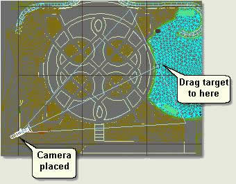

- Create Panel > Cameras > Target. The Target button turns orange showing the command is active. The cursor changes to a large cross
- In the Top viewport left click where you want the camera to be placed then drag (keeping the left finger on the mouse button) to where you want the target to be (ie where the camera will look). Take the left finger off the mouse button to finish the creation process
- Right click to end the command - the Target button turns back to grey

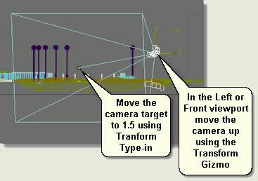

NOTE: In practice just place the camera roughly and then change the position of camera and target afterwards in the Top and Left viewports thus:
- Select Camera 01
- In the Left viewport move the camera up using the Transform Gizmo
- Select Camera 01.Target and use Move Transform Type-in dialog to move the target to 1.5
TIP: If the camera is to be placed at head height then the target needs to be roughly head height and perhaps down from the camera Z position slightly. The camera can be moved up or down over the site in the knowledge that if placed back at head height the target will be already correctly placed on the Z axis

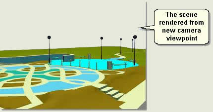

- Right click in the Front viewport to make it active and type C. This changes the viewport to a Camera viewport
- Change the viewport display to Smooth + Highlights
- In the Top viewport move the camera around and view the camera view in the Camera viewport
- Practice moving the camera and target independently in the Top viewport to gain many views and changing the height of the camera in the Left viewport
