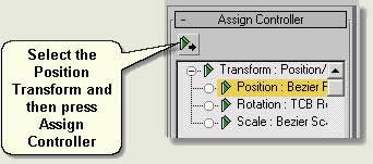

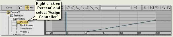

This tutorial introduces you to the fundamentals of controllers, time configuration, use of track view (in the Mini-Curve Editor to slow and speed objects up) and the animation controls by animating a camera along a camera path

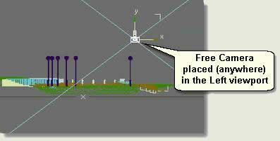

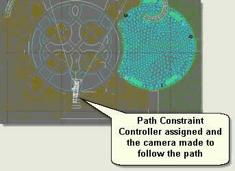

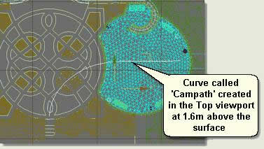

TIP: Always use NURBS Curves for camera animation. Curves are much smoother than splines. Using Snap to Face allows you to create a path that follows a the surface levels
NOTE: The camera is created in the Left viewport to keep the orientation of the camera correct when animated on the path

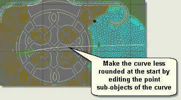

TIP: The animation starts with a big curve that will be rather distracting when viewed. Try and make curves rather wide if needed. this animation needs a fundamental change of direction as well as the speed altering to suit the output required thus:
The camera is moving too fast along the curve. A walking pace is about one metre per second. So, if you know the length of the line and how many frames per second the animation will be played back at, then you can quickly work out how many frames are needed for the animation
NOTE: A common mistake is to change the number of frames in the Animation section of the dialog. This will have the effect of moving the animation to on end of the time slider ie the speed will not be changed. The Rescale Time button must be used

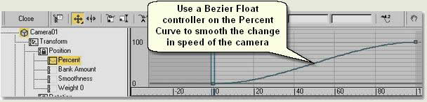

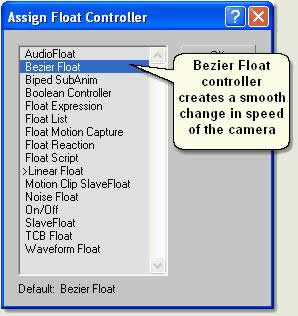

The animation is a little 'cluncky' because it starts and stops straight away and does'nt speed up to walking pace and then slow down at the end to a stop. Use the Mini Curve Editor to edit the start and stop of the animation and thus produce an 'easier' animation to view
TIP: Only panaround animations should start and stop straight away as these may be required to 'loop' on playback
TIP: If the camera appears to 'turn around' at the end of the camera path move the last key down slightly below 100 percent
