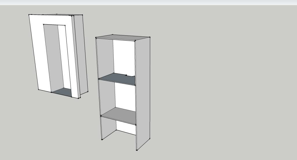

gcp310 Posted April 27, 2009 Share Posted April 27, 2009 heres the image, how do i divide the space with shelves evenly?? you can see i have one shelf in the middle, but would like to make this more. thanks G Quote Link to comment Share on other sites More sharing options...
JBullseye74 Posted April 27, 2009 Share Posted April 27, 2009 Measure the distance and offset construction lines to mid point. If you want more shelves then divide the distance to suit and offset more construction lines and copy your shelf up. Quote Link to comment Share on other sites More sharing options...
gcp310 Posted April 27, 2009 Author Share Posted April 27, 2009 thanks, but i thought there was an auto way of doing that, it may have been what i saw using parametric components, whcih you cant make in SU free. Quote Link to comment Share on other sites More sharing options...

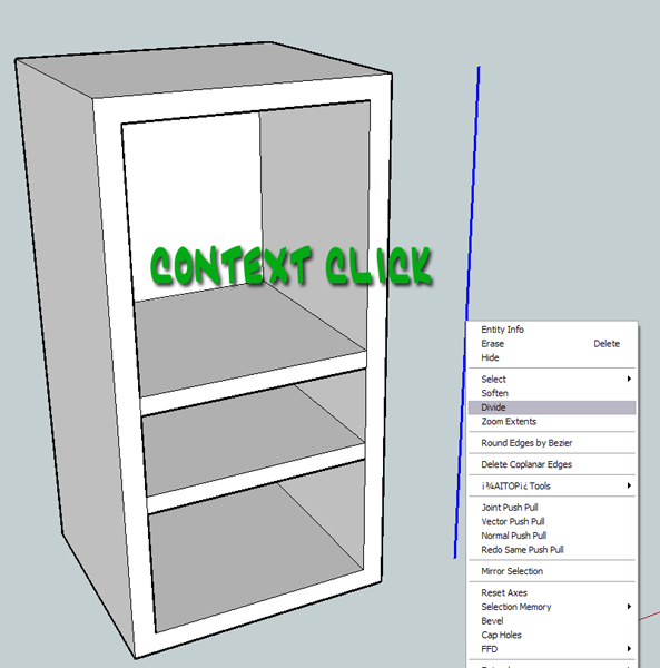

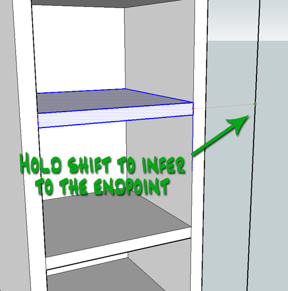

boofredlay Posted April 27, 2009 Share Posted April 27, 2009 There is an easier way. 1. Draw a line outside your cabinet. Context click (right click) the line and choose "Divide" and enter the division amount you want (or just move your cursor up and down until you get it). 2. Select the shelf geometry. Use the move tool and grab the center of the shelf. Move up or down holding Shift to lock it in the blue (vertical) direction. Then hover your cursor over one of the endpoints you just created on the line, click to finish the move. See images: Quote Link to comment Share on other sites More sharing options...
