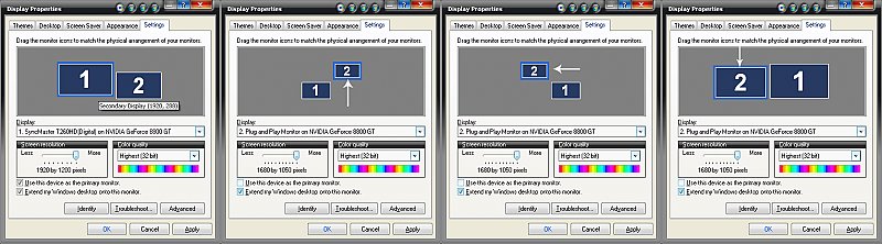

Where does your mouse exit the screen? Right or left? Can you change this? It always wants to exit on the right of my primary screen and I would like to change that.
I know I am a little late, but maybe this will help you.
Right Click on your desktop and go to properties.
Click on the settings tab.
Click the display on the right.
With your arrow keys, move the screen all the way up, then to the left, then down.
Click OK and see if that helps.
Cool, I would never have thought to do that. I will try that
Thanks
It worked....something so simple...wow
Thanks
Cool. My very first post actually helped someone.
Glad it worked fir ya.
Thanks and welcome to the board
