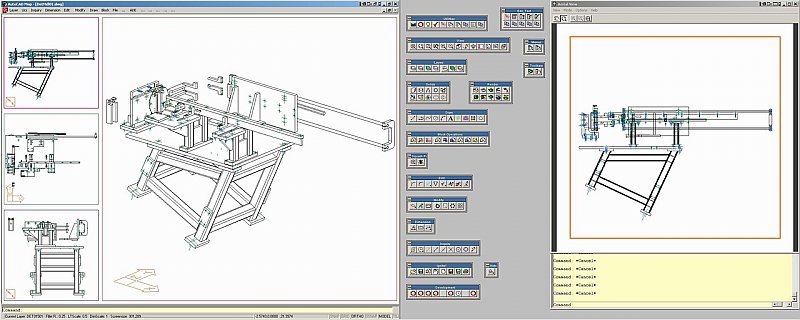

Patrick Hughes Posted April 26, 2009 Posted April 26, 2009 I've used a dual monitor set up for many years and consider the arrangement to be a great time saver. I typically have AutoCAD set to the left monitor and all toolbars and such floating on the right monitor. This way I maximize the drawing area which minimizes the number of pans and zooms. Also see what your video card's capabilities are. I've got multiple desktops that are easily switched, almost totally eliminates minimizing, maximizing, and arranging windows. I only wish I had dual 24's, 19's right now. Quote

Patrick Hughes Posted April 27, 2009 Posted April 27, 2009 Well if you liked that idea heres a screen shot of my set up. I don't know if the later versions of AutoCAD still have the aerial view, but that is what you see on the right monitor along with the text window. With my mouse set to automatically activate the window underneath itself I can very rapidly zoom in and out of my model. Quote
Currahee Posted April 27, 2009 Author Posted April 27, 2009 WOW..that is so cool. I can definitly see where this would increase productivity. My only question is how do I run the same application on the seperate monitors? Is it in clone mode or split screen? Quote
Patrick Hughes Posted April 27, 2009 Posted April 27, 2009 My Quadro driver calls the display mode "Horizontal span" It takes some tweaking but well worth the effort. You caught me just before I was shutting down, have a great night. Quote
Currahee Posted April 27, 2009 Author Posted April 27, 2009 My Quadro driver calls the display mode "Horizontal span" It takes some tweaking but well worth the effort. You caught me just before I was shutting down, have a great night. Oh..man, this is great!! I just figured it out. I didn't have to change a thing. All I have to do is drag the tool bars and windows over. I didn't realize that you could do that within an application. Now I will be up all night reconfiguring my workspace!! Thanks so much...talk to you tomorrow. Tim Quote
