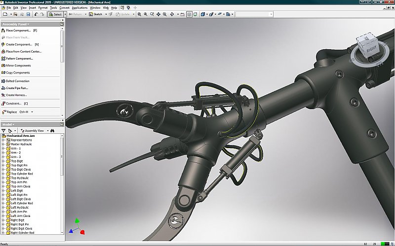

Devented Posted April 26, 2009 Posted April 26, 2009 So in this model, (pics posted) I have used a so called adapive wiring harness, however, when I extend the arm out, the wiring stays right where it is. Futhermore, the wiring running from the arm to the hydraulic of the "fingers" of the machine dont update unless I move them manually.. if I drive the angle constraint on them, they do not update... What I would like to be able to do I have a render animation of the arm moving back and forth, while the fingers open and close, all while ALL of the wiring (well, hydraulic piping....) gets updated. Any ideas? I wouls post the file, but even zipped its about 11mb Thanks in advance... Ryan Quote
shift1313 Posted April 27, 2009 Posted April 27, 2009 were the paths drawn as 3d sketches and constrained to the cylinders? were constraints added after? what happens if you manually pull the arm out(with your base grounded), do they update then? Quote
Devented Posted April 27, 2009 Author Posted April 27, 2009 Well like I said before, they were created using the Wiring harness command, so Im going to assume it auto created a 3d sketch and profile. I did not constrain them, but I did try, but constraint would not select them... And I didnt try maually pulling the arm out... Even if it does work, its kinda besides the point, as I cant record manually doing things.... Quote

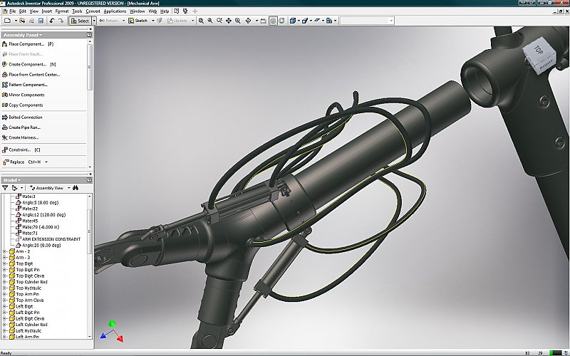

Devented Posted April 28, 2009 Author Posted April 28, 2009 BAH!!! This is even worse.. now that I'm home, I tried suppressing the constraint, and moving it manually.. It worked, but it seems as if only the start and end points are adaptive!!!! The rest of the points stay where they are! Is there maybe another feature that I could use that would get the results I desire? Because this is defeintly not working out! Quote

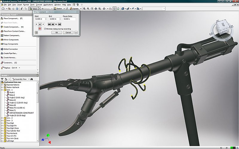

Devented Posted April 28, 2009 Author Posted April 28, 2009 Well I was able to get the piping to move with the model during a render.. Just used a "animate component" tool... now they move with the arm.. however, the adaptablity is sometihng I just cant figure out. Maybe I'm going beyond the scope of what IV was designed for... Quote
shift1313 Posted April 28, 2009 Posted April 28, 2009 i think its capable but unfortunately i just dont have any experience with it. I planned on playing with it last night just couldnt free up the time. I noticed in your model tree that none of your parts have the adaptive icon next to them. If you right click on them, is adaptive checked under you cable/harness parts? Did you draw each segment individually or were any copies? I did notice in some of the help files a mention of copied cables not being able to be adaptive. Not sure if that has anythin to do with your model or not. Quote
Devented Posted April 28, 2009 Author Posted April 28, 2009 Well the harnesses were each made seperataly, with a pair in each harness assembly.. So there are 3 different harness assemblies.. They are adaptive, when i move the model manually... They update when i choose a final location for the "fingers" to rest... They do have adaptability checked... Also, they would be the only parts that need to be adaptive i bealieve, as everything else works together without needing to be adaptive. I need them to be constrained and move like they are attached to the "arm", but also keep their adaptivity with the hydraulics.. I need them to act real lol... Its just when i try and animate them that they seem to lose all association with their respective connections. Im even a little confused as to why I had to use an animate component constraint (or whatever it would be called) on them, as they seem to be attached to the model in the assembly view. It seems more like they are just coasting along side of the model... Not really attached to anything, just following their path.. If a copy of the model would help more, let me know of a way I can get it to you, its around 12mb, and I dont mind sending it. Ryan Quote
