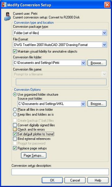

kart_trik Posted January 17, 2008 Share Posted January 17, 2008 Dear all, I have a bunch of autocad drgs in say 2004 version . how could i save these drgs in 2000 version by using single step. i know to save these drgs individually but i have got about 200 drgs to be converted to 2000 version. somebody help Regards K.S.Karthik:) Quote Link to comment Share on other sites More sharing options...

mahahaavaaha Posted January 17, 2008 Share Posted January 17, 2008 Hi, get free Autodesk TrueView from http://www.autodesk.com. This lets you batch-convert dwg's with lots of options: Formats: Other Options: Note that it will automatically do an audit if requested, bind xrefs and remove plotterdefinitions! Cheers, Petri Quote Link to comment Share on other sites More sharing options...
