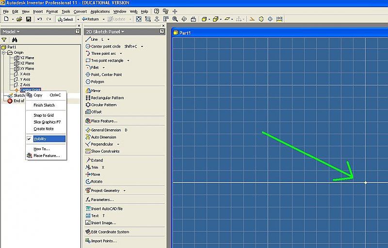

no i dont how to turn on an origin point, but if you could help me that would be great :) I am using inventor 11 but what about the 1in lip?
do you have an image or screen shot you can show me so i have a better idea what you are trying to draw. Or maybe give me some dimensions.
To turn on your origin expand your Origin folder on the model tree, right click on the origin and select VISIBILITY. A check mark will be placed next to it and now your sketch plane will show a yellow dot. That is 0,0. It is good practice to work with the origin and not just randomly start drawing.
