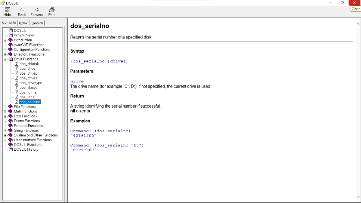

marko_ribar Posted April 2, 2024 Posted April 2, 2024 I think that (dos_serialno) needs drive letters as arguments... Your syntax is complex, or I am missing something... Look at picture from documentation : Quote
Tomislav Posted April 2, 2024 Posted April 2, 2024 I didn't write this lisp, I'm nowhere that capable, just wanted to see how it works, but that line keeps returning error... Do I need that doslib library to put somewhere? Quote
