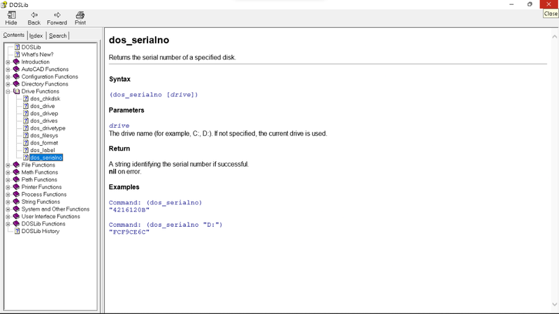

I've put together some nice code written by dilan, for beginners like me.
Others have also been collected and links have been attached.
command is SYSINFO
- Drive serial is not manufacturer's unique serial number. this can be change with just formatting
