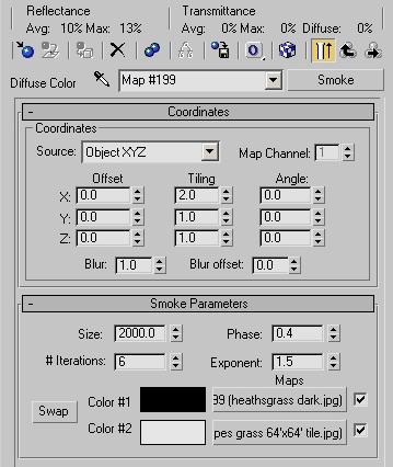

wbroberts Posted January 15, 2008 Posted January 15, 2008 I'm not sure about tutorials online for this.....I've searched for years and have only found bits and pieces....there is a lot on displacement grass tutorials......but for some reason it is a "trade secret" or something..... these are the settings I used to do this rendering i'm working on right now....it is a MR Arch & Design shader; with smoke in the diffuse slot using two separate grass maps, that gets rid of the tiling and gives you that natural mix of shades and texture....darken your image maps Output RGB level to something .5 or .4 ( ...of course there are probably a million different combinations to achieve this look.....ie noise maps, mix map et al These attached grass maps have worked very well for me (and others) in the past by making them about 8' wide and mixing them in the slots.....experimenting with different texture images is the best way to go about you scenes.... [/ATTACH] Quote

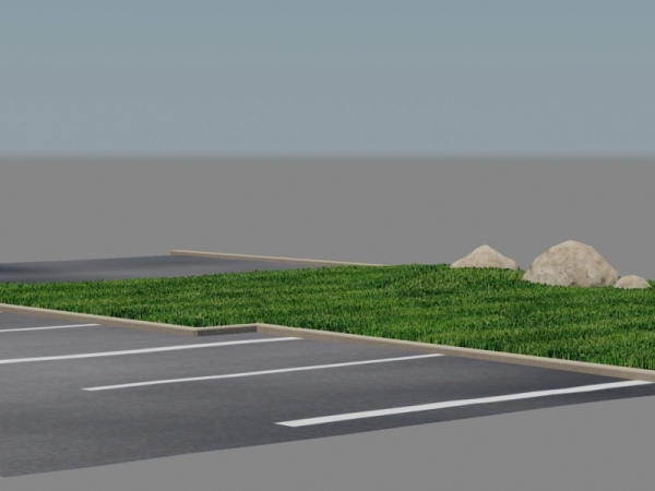

wbroberts Posted January 29, 2008 Posted January 29, 2008 Cad64 said: Just found this tutorial posted on another site: http://jeffpatton.net/MR_Grass_Displacement.htm yeah, that is a very good tutorial on the process.....it helped me with the concept of MR micro displacement years back.....as it is a processor-hungry procedure, render optimization is the key to grass displacement.....as anyone will warn you though, avoid large "fields" and use it in the foreground with either falloffs or masks to regular bitmapped grass in the receding distance....I use it for my sites in the parking islands and front lawns et al.....I finally got this 800x600 test to 01:30 via optimizing the model and renderer this past year.... Quote

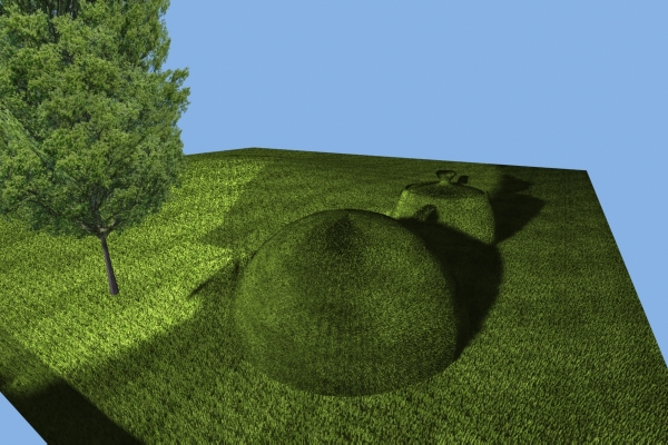

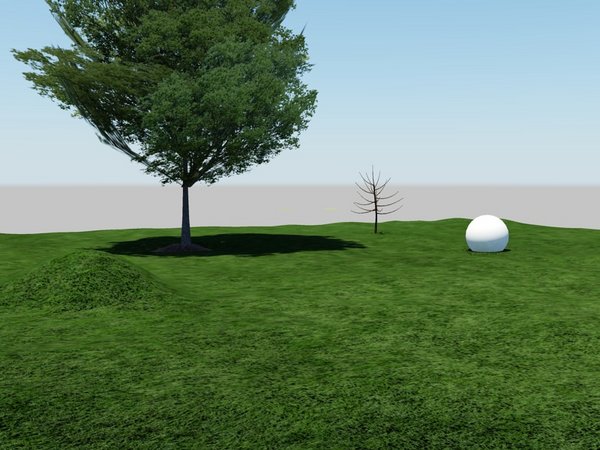

wbroberts Posted February 1, 2008 Posted February 1, 2008 wbroberts said: yeah, that is a very good tutorial on the process.....it helped me with the concept of MR micro displacement years back.....as it is a processor-hungry procedure, render optimization is the key to grass displacement.....as anyone will warn you though, avoid large "fields" and use it in the foreground with either falloffs or masks to regular bitmapped grass in the receding distance....I use it for my sites in the parking islands and front lawns et al.....I finally got this 800x600 test to 01:30 via optimizing the model and renderer this past year.... ......but this is the future for grass....parallax normal relief mapping....it renders so fast....40 seconds for this test...but it doesn't support mental ray...just vray and scanline (this test)....this would work for a field..... Quote
Cad64 Posted February 2, 2008 Posted February 2, 2008 wbroberts said: ...but it doesn't support mental ray...just vray and scanline That's some nice looking grass, and so fast too! But I don't have Vray and I prefer Mental Ray over scanline, so I guess I'll just have to keep doing it the way I've been doing it. Quote
wbroberts Posted February 2, 2008 Posted February 2, 2008 Cad64 said: That's some nice looking grass, and so fast too! But I don't have Vray and I prefer Mental Ray over scanline, so I guess I'll just have to keep doing it the way I've been doing it. ....yeah, i prefer MR to scanline too, but writing plugins that run with that render engine are very difficult....i never learned scanline well enough to get the results that some got from it back in the day either....but I believe that this new steep parallax technology is the solution to a lot of the current texturing problems people experience with arch viz today since it avoids the memory hungry micro subdivisions required with decent displacement et al..that plane in the test has two faces!.....anyone know mental ray code well enough???? Quote
