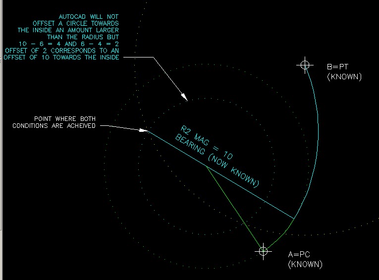

How do I construct a sort of compound curve using Autocad?
What I got is a circle or arc of about R=6. A node or endpoint about 5-6 units away from the center. I want a curve of R=10 to create an arc to go through the endpoint, and be tangent to the arc too. I can visualize it, but cannot draft it.
Now, I realize that there are a few possible solutions, but only one applies. I tried using the 2P function on curves, but instead of being tangent to the curve it comes up at a right angle to it. I can draw a tangent solution within a couple of seconds, but a curve?
Due to wrong soultions, I used to have a solution to this that involved drawing a few offset lines, but cannot remember how that was as I used it so seldom.
If I got 4-6 solutions, could I then delete or pick the one I preferred?

Is this what you're asking about?
[ATTACH]11571[/ATTACH]
Your PDF is difficult to see but....
The endpoint B=PT has coordinates fixed. Cannot be altered.
The endpoint A=PC has coordinates fixed. Cannot be altered.
R-2 is 10 units. Of any bearing.
R-1 is of 6 units. Known bearing.
Delta 1 and Delta 2 are unknown.
The bearing to center of R-1 is known, the bearing of tangent is known.
The bearing to center of R-2 is unknown, the bearing of tangent to circle (arc) R-2 is unknown. This sort of makes the tangent line a broken-back.
The bearing of line O2 to PCC is unknown, but lengths along this line known.
Wm.

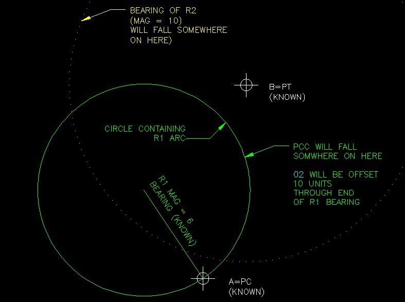

One method would be as shown in the attached images. The one step that is not AutoCAD friendly is offsetting a 6 radius circle 10 towards the inside. Requires some math.
