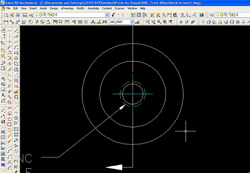

Rise Posted April 22, 2009 Posted April 22, 2009 Is it possible to find out how much 2 solids intersect each other using AutoCAD Mechanical 2007? Quote

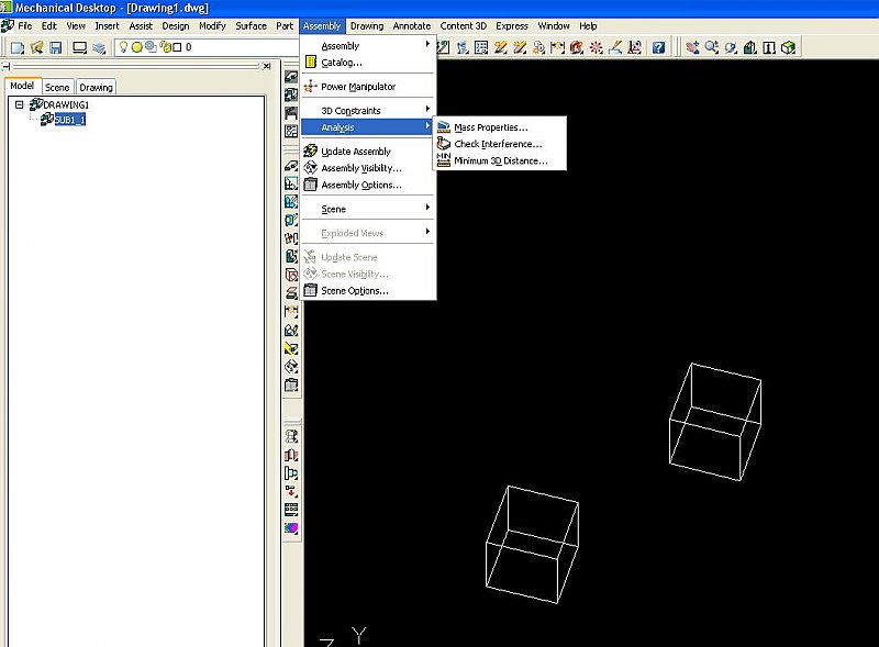

shift1313 Posted April 22, 2009 Posted April 22, 2009 under your assembly menu up top, there is an analysis tab and an interference option. I havent used mechanical in a long time and never used this feature but im sure the Help file will give you something to go off. You will need to have correctly modeled an assembly for this to work i believe. Quote

shift1313 Posted April 22, 2009 Posted April 22, 2009 at the top of your screen where file edit view and all that is. There is no assembly menu? Here is a screen shot i just took from MDT07 Quote

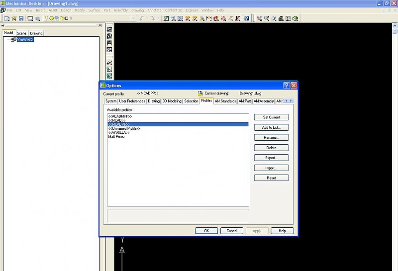

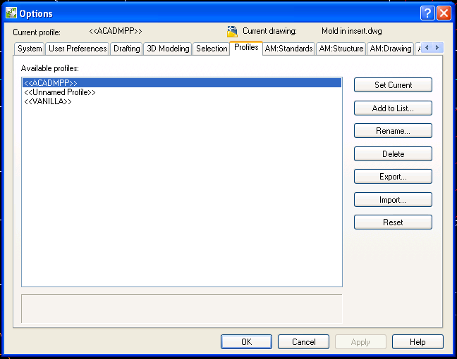

shift1313 Posted April 22, 2009 Posted April 22, 2009 looks like you might be on the acad profile. Go to Assist>Options, then i your options window go over to the profiles tab and tell me what profilie you are on. Here is a screen shot of the window. There are different profiles which make the program have a different interface. You can use MDT as if it were autocad(vanilla and acadmpp profiles). you can also create your own. Quote
Rise Posted April 22, 2009 Author Posted April 22, 2009 I'm on ACADMPP, and this is what I have available: Quote

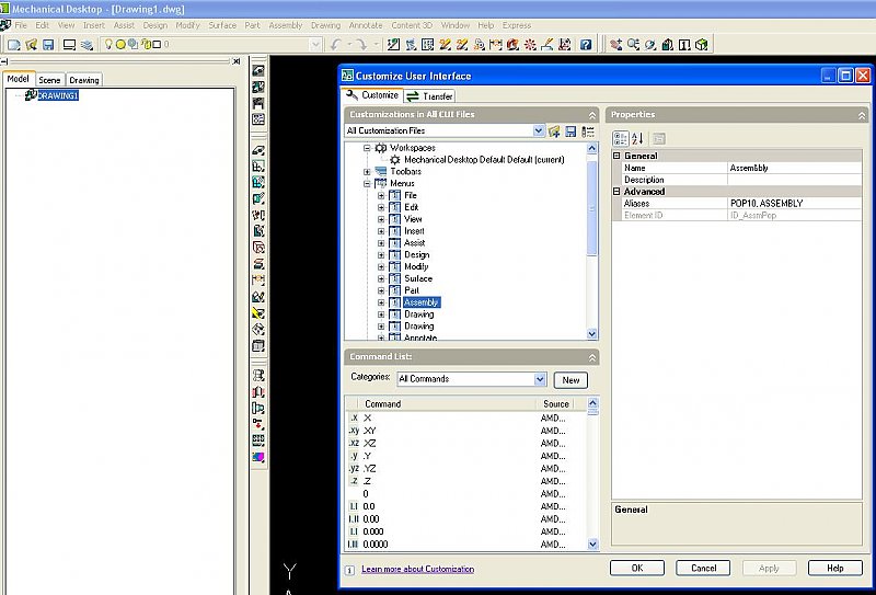

shift1313 Posted April 22, 2009 Posted April 22, 2009 well you can make a custom profile. Did you do the install for your computer or is this a work computer? do something else for me, under your Assist menu Customize>interface Look under your Menus like in the screen shot and see if Assembly is there. It probably wont be but im curious. I honestly dont remember how to modify the profiles to include everything, i would have to play around a bit to figure it out. I never use MDT so im hoping someone else will chime in for you. Quote
Rise Posted April 22, 2009 Author Posted April 22, 2009 no, assembly is not there... yeah this is a work computer, but I have access to the install discs and what not. should i think about re-installing? Quote
