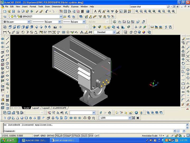

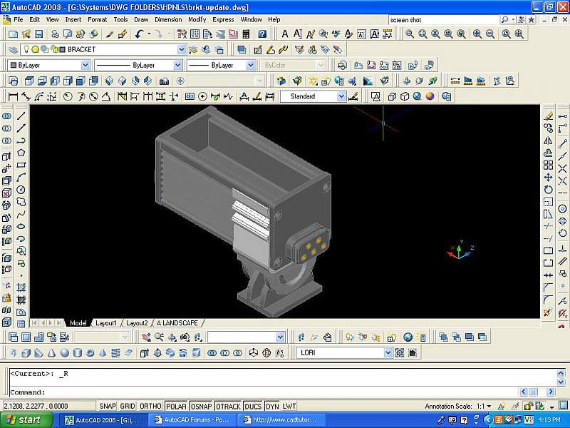

I Have Been Racking My Brain To Figure Out This View I Have Been Through All Of The Settings But Cant Figure Out Why The 2 Views Are Differant The Untittled Image Is The One I Am Trying To Achieve, Can Any One Help Me Out More Than Likely It Is Something Simple. I Like The Image Where The Metal Looks Like Metal.

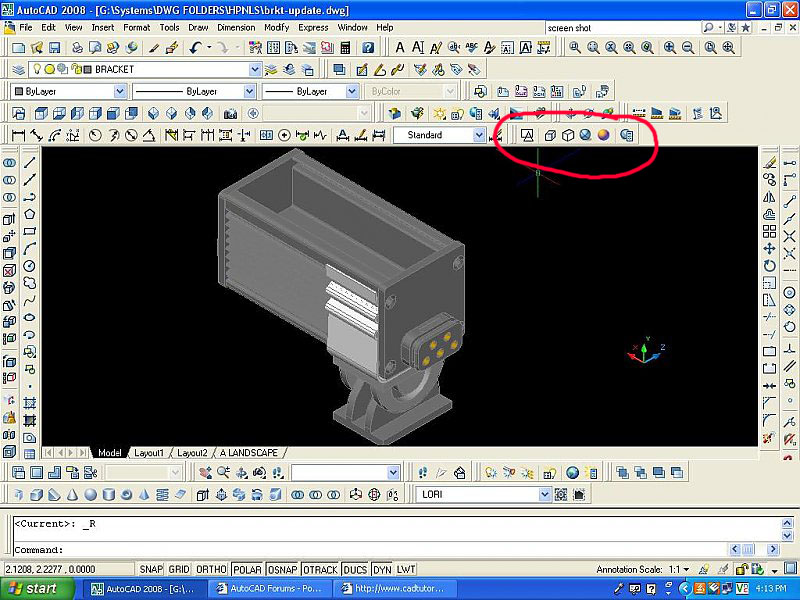

Try playing with your visual settings. (see attached image) I beleive this will get what you are looking for. For more options, you can click on the 'Visual Styles Manager' button on the far right of the tool bar.
i've done that it seems to be a custom view but cant figure it out, you go to style mang and it has "custom" in the drop down but no custom made so a little frustrated.
-shademode Gourard (don't forget the minus sign - )
