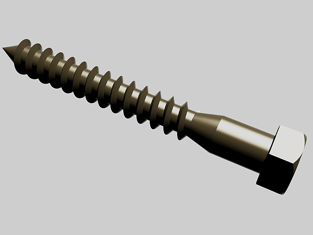

cad_student Posted April 21, 2009 Posted April 21, 2009 Hi All, I have been following this tutorial http://www.dailycad.com/2008/06/auto...threaded-bolt/ But seem to be stuck on the sweeping of the triangle (3 side poly),Have followed the tut to the letter but no luck,I have also experimented with alternatives but again no success (still very new to 3d acad). Has anyone else had similar prob's and might be able to help?? As alway's any help is greatly appreciated. Have included my attempt for reference. Quote

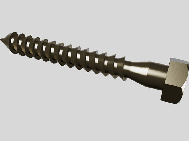

cad_student Posted April 21, 2009 Author Posted April 21, 2009 AAAAAA-HA ,Got it at last!!!, Many thank's for everyone's help,It turn's out it was a ucs prob on my part:?,And here it is... Quote
kencaz Posted April 22, 2009 Posted April 22, 2009 AAAAAA-HA ,Got it at last!!!, Many thank's for everyone's help,It turn's out it was a ucs prob on my part:?,And here it is... Looks great... I was going to suggest try changing the base point of the swept object and even rotating it will give you different results. KC Quote
