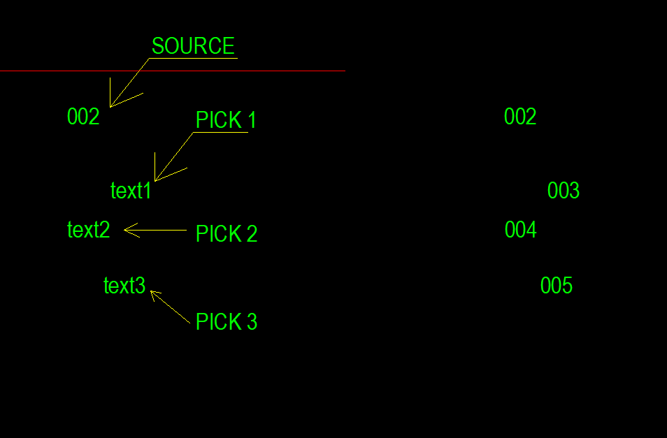

hello all:
some routine to number like this...
1.-Select a source text with numeric data. example "002"
2.- Then select the texts one by one and number them, giving them the consecutive number to the original value.
3.-Modified texts will always have 3 digits at the end. example: 001 , 034, 100....
You have many posts so you should know by now all the functions required, so have a go.
pick text then atoi
(while pick text
next number check is 2 or 3 digits <10 <100 so pad with "0"
update text entmod or vlax-put 'textstring
) end while

I did this using Lee Macs Copy Swap Text LISP as a basis, adding in the increment portion as required.
Why not something different...?

Simply: insert new text or modify existing text based on the cursor position.
Note: I have only included "TEXT" objects in the code consideration.

	(if (wcmatch (setq ind (cdr (assoc 1 lstent))) "#,##,###,####")
	  (setq ind (atoi ind) capa (cdr (assoc 8 lstent)) a (cdr (assoc 40 lstent)) para T)
	  (princ "\n*** The selected object is not valid. Please, try again... ***")
      (setq para T)
  (setq	error0	*error*
	*error*	errores
  (setq tam (* (getvar "pickbox") (/ (GETVAR "VIEWSIZE") (CADR (GETVAR "SCREENSIZE")))) para nil)
  (princ "\nSelect text to modify or insert new text (RIGHT CLICK for exit)...")
  (while (and (setq l (grread T (if s 4 13) (if s 2 0))) (member (car l) '(5 3)))
    (if (setq s (ssget "_C" (list (- (car (setq p (cadr l))) tam) (- (cadr p) tam))
			    (list (+ (car p) tam) (+ (cadr p) tam))
		            (list (cons 0 "TEXT"))
      (cond
	((= (car l) 3)
	 (entmod (subst (cons 1 (dameTexto)) (assoc 1 (setq le (entget (ssname s 0)))) le))
        ;Here are other possible cases
      (cond
	((= (car l) 3)
	 (entmake (list	'(0 . "TEXT")
			(cons 8 capa)
			(cons 40 a)
			(cons 10 (list (car p) (cadr p) 0.0))
I'm testing your code. But when I zoom in/out during the command, the switch from crosshair to pickbox doesn't work as expected.
Is there a way to fix this?
