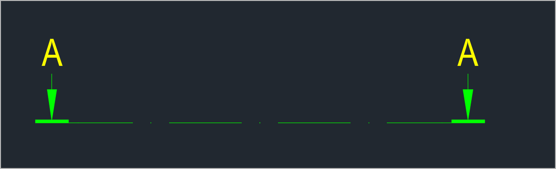

Hi PGIA, lemme explain with screenshots:
Say I have a section line, like this:

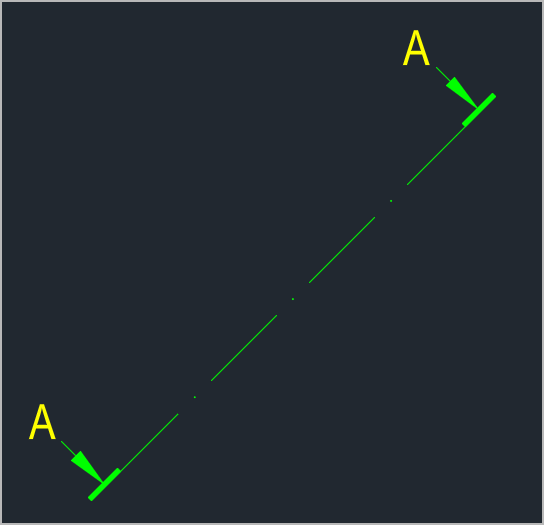

What I do first is rotate the whole thing, like this:

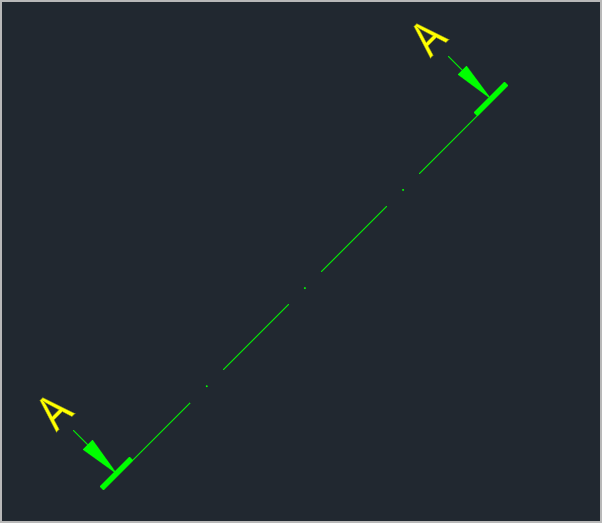

The problem is, I want the text to be horizontal, no angle, so then I have to select the text and rotate it back to 0°, like this:
So the rotate command is needed because I still need to rotate everything, hope this clarifies my issue.
