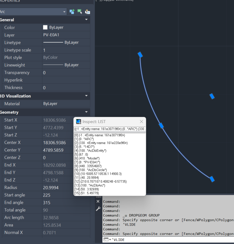

Hi everyone,
I noticed something confusing while inspecting an ARC entity in AutoCAD using AutoLISP. When I use entget to examine the arc, DXF code 10 returns a specific point — but it doesn't match the Start X/Y/Z values shown in the Properties panel.
For example:
Why are these different?
I thought DXF code 10 might represent the start point, but it looks like it's actually something else. Could someone explain what this value actually represents, and why it's different from the Start Point shown in the Properties palette?
Thanks in advance!

Thank you for the explanation @Emmanuel Delay. But I had already mentioned that I know code 10 represents the center point.
What I'm actually wondering is why I can't access the Start Point shown in the Properties panel through entget.
My goal is to set the Z value of the center, start, and end points of an ARC entity to 0. I can get the center point from DXF code 10, but I can’t access or modify the start and end points directly.
Hi @p7q,
I suppose it's because every entity (LINE, CIRCLE, ARC, etc.) have they own DXF codes which are they describe them. Every additional code, means you need to use XDATA.
As you can se from this reference (and it's looks like from your picture), there is DXF codes which describe the ARC entity, and it's matching from your picture, except of those which are default (-1 . <Entity name: 161e30719f0> (but the entity name is changeable everytime when you close and open again the same drawing), 5 . "14D7", etc.).
So, if you want to get a start and end point of an ARC entity, you need to use:
(setq ent (car (entsel "\nSelect ARC entity:")))
(setq obj (vlax-ename->vla-object ent))
(setq spt (vlax-curve-getStartPoint obj)) ;; you will get a start point
(setq ept (vlax-curve-getEndPoint obj)) ;; you will get a end point
...... the rest of your code
Additional, if you want a list of all Properties which are available to an ARC entity, use this (you will find start and end point here):
(vlax-dump-object obj)

T
I think that is the reason why you can't get a start/end point from using (entget (car (etnsel))).

I seem to remember that you can't change the elevation of the start/end points, which is why they're greyed out in the properties. You can change the center point's elevation, which makes things easier.
  • Agree 1
Right.
Autocad is still a technical drawing program, mimicing pen and paper.
The user can tilt the paper (UCS), and then draws on that plane.
So a circle or an arc means that you set the needle on thet plane, then you draw on that plane.
You can't elevate the start or endpoint.
You can elevate the whole arc, you can tilt the plane on which the arc is drawn...
If you could elevate just 1 start or endpoint then it's no longer an arc.
That's the general idea, it's not absolutely true, since there are things like 3D polylines
That is also true. From above post, there is: "; EndPoint (RO) = (2922.48 1382.31 60.0)" and "; StartPoint (RO) = (2726.12 1946.53 60.0)" which mean that those values are Read-Only.

Just to clarify what I’m seeing — because I think the key point might be a bit different than just the Z elevation.
If an ARC looks like a curve in Top view and also looks like a curve in Front view, then that arc must be in a 3D plane, not flat on the XY plane.
Now here’s the interesting part:
When I use FLATTEN, the same arc still looks like a proper arc in Top view — but in Front view, it now appears as just a straight line.
So visually, it's become completely 2D — even though it's still technically an ARC entity. That means FLATTEN is not just setting the center Z to 0 — it's also resetting the arc's plane (Normal vector) so that it's perfectly flat on the XY plane.
I had tried doing this manually in code, by setting the center Z to 0 and the normal to (0 0 1), like this:
(if (member entType '("ARC" "CIRCLE" "ELLIPSE"))
    (setq objj (vlax-ename->vla-object obj))
    (vla-put-Center
      objj
      (vlax-3d-point
        (list (car (vlax-get objj 'Center))
              (cadr (vlax-get objj 'Center))
              0.0
    (vlax-put objj 'Normal (list 0.0 0.0 1.0))
But this sometimes gives me a “General modeling failure” error. So clearly, FLATTEN is doing something internally that’s more robust than just setting the center and normal.
That’s what I’m trying to figure out — how exactly does FLATTEN make a 3D arc truly 2D without errors, and why doesn’t the same thing always work when done through code?

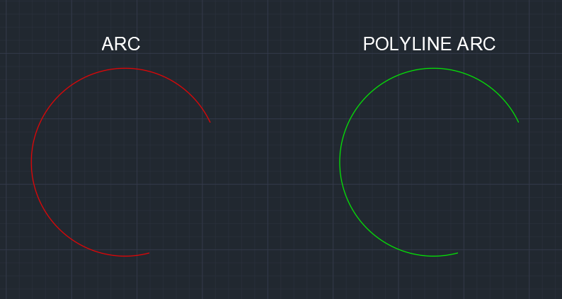

I realized that I can't change the start and end points. Thank you. Is there another method other than VLA-OBJECT?
Maybe you can create insted of Arc a Polyline Arc, like from this Lee Mac Bulge Conversion Functions.
It will look like this:
Try with that and see if it helpful.

My guess is that the original arc was not drawn in the World UCS. That's why you get a 210 code, to define the object's original plane.
Another guess, FLATTEN translates the center point to the XY plane and then redefines the arc as if you'd drawn it in World UCS. That's why it doesn't look like what you expect. The new start/end points have no relation to the originals.
