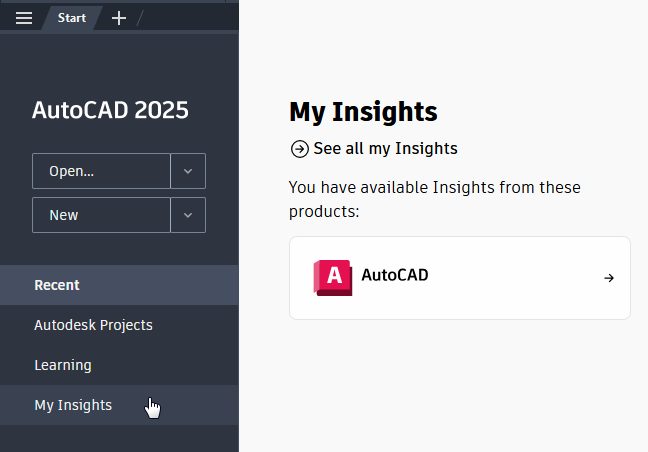

You can access it in several ways. The easiest is probably via the Start Tab in AutoCAD (below image – left.) You can also find My Insights from your Autodesk account page (below image – right). You can even have Autodesk email your insights to you. Sorry, snail mail is not available.

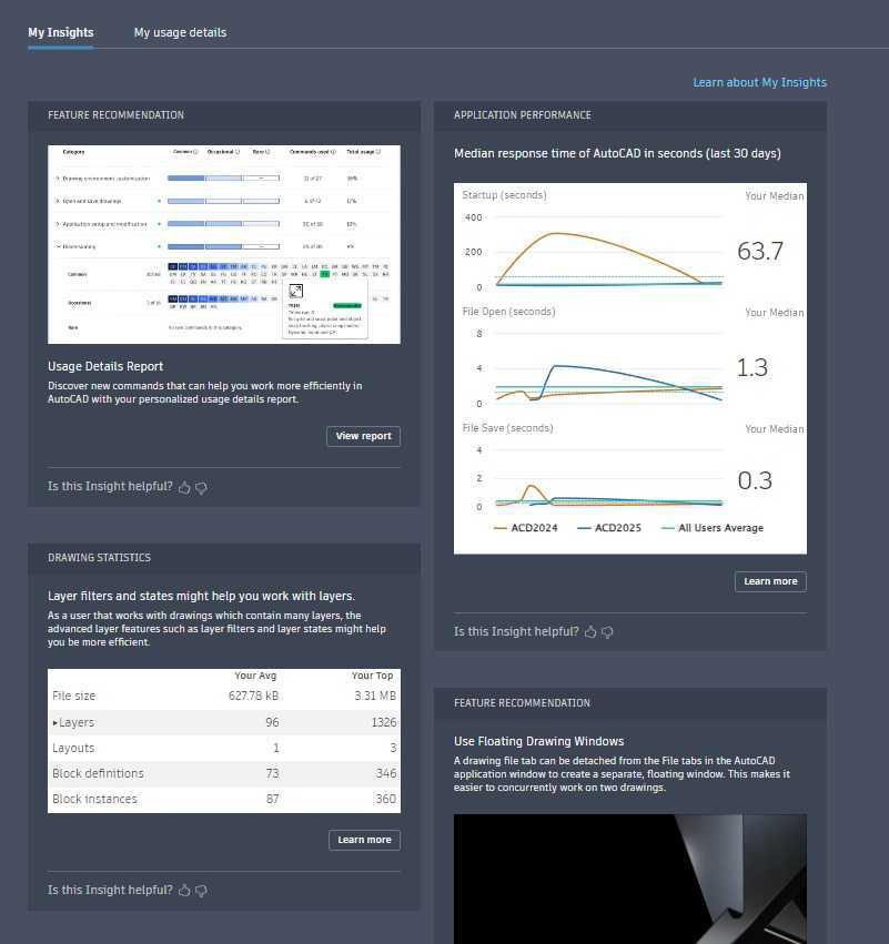

When you go to your My Insights page, you’ll see two tabs. The page will begin with the My Insights tab open. Here, you find things like recommendations for various tools or features that may improve your workflow. In the image below, you’ll notice that My Insights is suggesting that the user utilize Floating Drawing Windows. It has analyzed the workflow and noticed that multiple drawings are often being worked on simultaneously.
You’ll also see a personalized usage detail report, which can also help you work more efficiently. How well is AutoCAD itself responding for you? Here, you’ll get a chart showing median response times for startup, file opens, and file saves. So the next time you go to IT asking for a faster computer, you’ll be armed with accurate stats.
My Insights tab screenshot
How’s this for a cool Insight? Autodesk has noticed (bottom left of image) that the user is often working with a high number of layers and has suggested using Layer States and Filters to be more efficient. Are you not familiar with those features? Just click on the Learn More button!

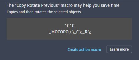

You may also get suggested Action Macros based on your usage. In the below example, instead of using the three commands Move, Copy, and Rotate, My Insights offers a macro that utilizes the Express Tool called MoCoRo.

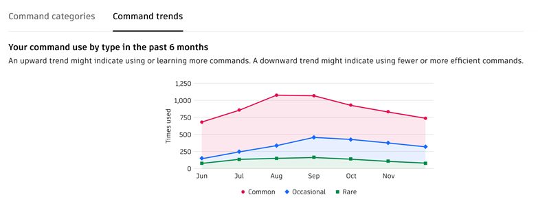

The other tab is Command Trends. Here, you can see a line chart showing your command usage over the last six months. It is broken down into common, occasional, and rare types.

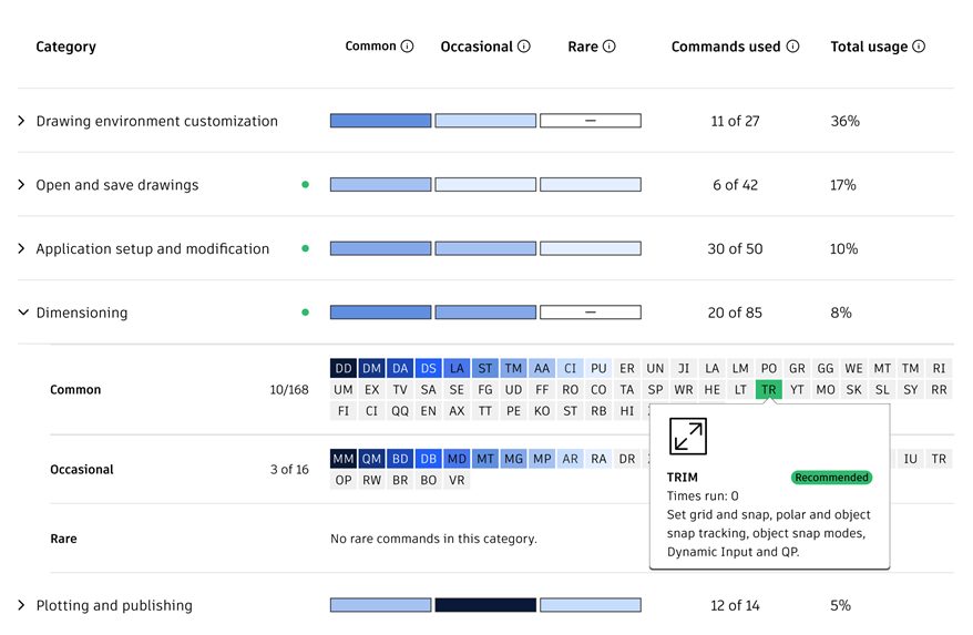

At the bottom of the My Usage Details tab, there is another handy chart that displays details about your Top 10 command categories in the past 30 days: frequency of use by type, commands used, and total usage. If you’d like more information on an entry, just expand the row for a detailed chart of what commands you’ve used.
