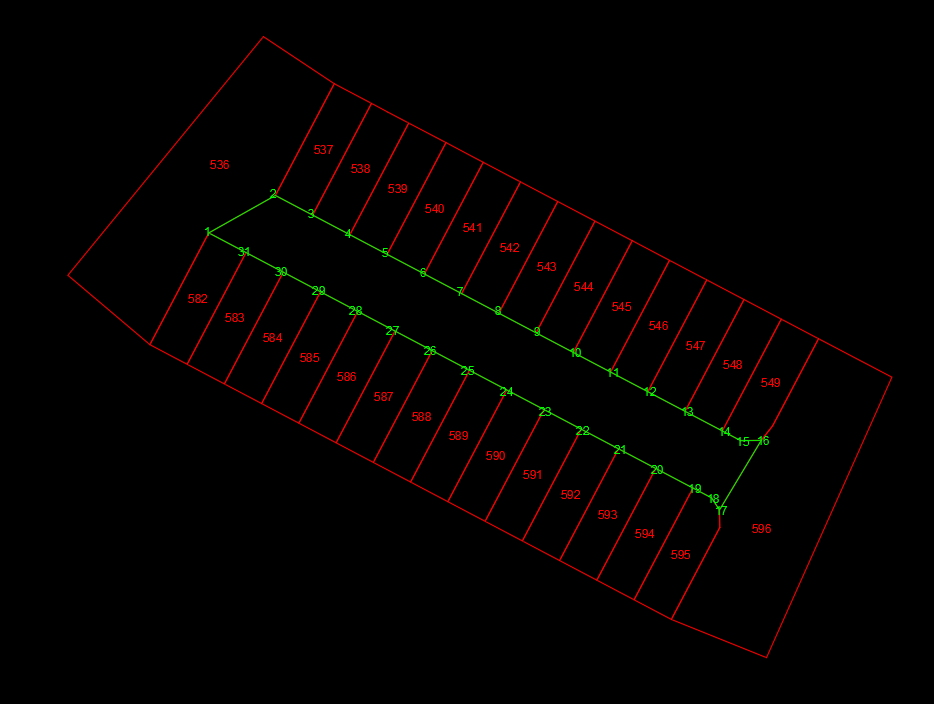

Guys, as I show in the attached image,
If there is already a lisp that extracts the text from the polygon segment and generates a table or exports it to csv, on each side that contains text (each text will be inside a closed polygon).
use the sequence of the original vertex of the polygon as a reference.
I tried to find something similar but I couldn't find it.
Thanks for your help.
Sampple side.dwgFetching info...
A possible algorithm might be:
  1. Obtain set of vertex text (green text).
  2. Obtain set of region label text (red text).
  3. Obtain green polyline.
  4. Iterate over the set of polyline vertices and associate the green text content with each vertex by matching the text position with the vertex coordinates (so that the vertices can be labelled independently of their sequence in the polyline definition).
  5. For each red text object, call the BOUNDARY command to create a temporary boundary polyline using the text insertion point/alignment point as the internal point.
  6. Attempt to match the vertices of the boundary polyline with those of the green polyline and acquire the vertex numbers for all matches.
  7. Create a range from the matching vertex numbers.
  8. Delete the temporary boundary polyline.
  9. Continue until all red text objects have been processed.
  10. Sort the results by minimum vertex number in the vertex number range.
to minimize, you don't even need to count the vertexes, if you only have a list of the sequence of the sides following the original sequence in the polygon it would be enough.
this data will already be ready and nothing will be created (I refer to the texts), when the green numbering I left it just as an illustration but it doesn't even need to exist, because the reference will always be the vertexes of the polygon.

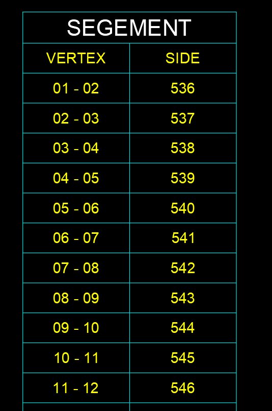

Hi @leo321,
I'v been played with this and made:
; Functions        :  TXTBL
; Subfunctions     :  -
; Description      :  Put the TEXT or MTEXT values into the tabel in model space
; Author           :  SAXLLE
; Date             :  April 03, 2025
(prompt "\nTo run a LISP type: TXTBL")

As you can see on the picture from belowed, the "output tabel using lisp" is what I get using lisp from above, but there is one thing, when formatting "VERTEX" column, I get "9 - 10" insted of "09 - 10" (you can see the red rectangle). Also, it isn't formatted as yours "Your tabel" from picture (I'm not yet familiar with all things about the Tabel formatting, sorry 🫤). I didn't mention, I use this for "ssget" filter '((0 . "LINE,LWPOLYLINE") (8 . "LIXO") (62 . 3)))), '((0 . "TEXT,MTEXT") (8 . "LOTE")) and '((0 . "LWPOLYLINE") (8 . "LOTE")), if you have different layers names/colors, it wont work.
I hope it will helpful for your purpose. If you have maybe larger drawing, please upload it, just for the test.
Best regards.
Edited by Saxlle
It turned out exactly as I wanted, I'm going to test it on other models.
I'll let you know if there's anything new.
Thank you very much

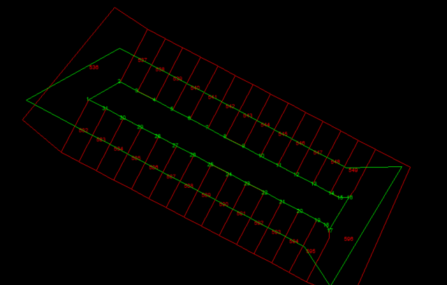

One pottentional issue can be occured when this line of code executed "(setq ent (ssget '((0 . "LINE,LWPOLYLINE") (8 . "LIXO") (62 . 3))))" and if you select many "green" lines, it will stop working. I tested it on "one by one" selecting, executing, place tabel and fill tabel with data, then re-run it and use it again.
