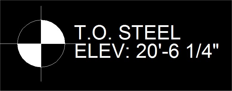

I'm constantly hounded by requests from the field to give them the top of steel elevation of this, bottom of steel elevation of that. So I'm looking for something to basically do this:
1. Enter the elevation of the baseline, which usually would be the top of the 1st floor slab, or it will just default to 0'-0"
2. Then by simply clicking on the points I want the items shown in the attached jpg will appear, formatted in feet/inches.
3. This will always be separate from the regular submittal drawings so it should create it's own layer and keep everything in there.
I started this myself but then realized I still just don't know enough about LISP to make it work.

Okay, I've got it started and it's working to some degree. What I need assistance with is how to get this to put the elevation marker at the getpoint location and then format the text so that it's a little cleaner, left aligned and the fraction in the ytxt point formated to be diagonally stacked.
And I guess a few error traps would be nice to polish this one off nicely.

This now produces this at the desired input points:

Here's a cheats way :P

PS> I would STRONGLY advise you use Entmake to create your text instead of a command call - the command call is very very unreliable and can produce some undesired results a lot of the time. Also, entmake is a ton quicker.
Ok, now without Cheating... :P :P

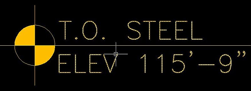

I'm not completely happy with it however - as it doesn't include the hatch that you use in your posted drawing.
I first used the "Point" command (with PDMODE set to 34), as this almost looks like the symbol you posted (but as I said, thats cheating!). :D
I am not confident in entmaking hatch - so I may post a thread detailing the that question.
But I shall look into the UCS problem :)
Cheers
Lee
Ok, so I posted the thread, then managed to work it out for myself:

 (if (not (tblsearch "LAYER" "ELEVTEXT"))
   (vla-put-color (vla-add (vla-get-Layers doc) "ELEVTEXT") acYellow)
   (setvar "CLAYER" "ELEVTEXT"))
 (if (not (tblsearch "BLOCK" "eMark"))
   (Make_Block "eMark" (getvar 'TEXTSIZE)))
 (while (setq ePt (getpoint "\nSelect Elevation Point: "))
   (Put_Block ePt "eMark" "ELEVTEXT")
 ;(vla-addPoint spc (vlax-3D-point ePt))
   (setq tPt (polar ePt 0 (* 2.5 (getvar "TEXTSIZE"))))
   (Make_Text tPt "T.O. STEEL" 0.0 1)
   (setq tStr (strcat "ELEV: " (rtos (cadr (trans ePt 0 2)) 4 4)))
   (Make_Text tPt tStr 0.0 3))

But I haven't yet looked at the UCS problem :(
See if this solves the UCS issue:
(defun c:elab  (/ *error* ovar vlst doc spc ePt tPt tStr)
 (defun *error*  (msg)
   (if ovar
     (mapcar 'setvar vlst ovar))
   (if (not (member msg '("Function cancelled" "quit / exit abort")))
     (princ "\n<<-- cancelled -->>"))
   (princ))
 (setq doc (vla-get-ActiveDocument
             (vlax-get-acad-object))
       spc (if (zerop (vla-get-activespace doc))
             (if (= (vla-get-mspace doc) :vlax-true)
               (vla-get-modelspace doc)
               (vla-get-paperspace doc))
             (vla-get-modelspace doc)))
 (setq vlst '("CLAYER" "DIMZIN")
       ovar (mapcar 'getvar vlst))
 (setvar "DIMZIN" 1)
   (Put_Block (trans ePt 1 0) "eMark" "ELEVTEXT")
   (setq tPt (polar (trans ePt 1 0) 0 (* 2.5 (getvar "TEXTSIZE"))))
   (setq tStr (strcat "ELEV: " (rtos (cadr (trans ePt 1 0)) 4 4)))
 (princ))

I also changed the setting of the OSMODE, so that snaps wouldn't be turned off unnecessarily. :oops:
Lee,
You are a gentleman and a scholar. Thanks a million for this valuable code that I will scour over and learn the finer point of in more detail.
This utility is also going to save loads of time as well as give me an accurate way to hand the field more information.
Many thanks Bill - I take it that it worked as you desired :D
Again, if you have any questions regarding any element of the code, I would be more than happy to go into detail and explain things. :)
Lee
Sorry I didn't get to test this until this morning. I'm not sure what this one is but this error message came up when I tried to run this one.
Error: no function definition: VLAX-GET-ACAD-OBJECT
Any clues?
