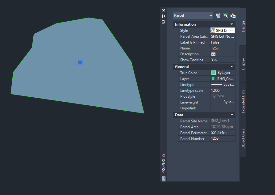

I have a civil3d (2025) file where parcels of different types are hachured using parameters within the parcel styles
 When I export the civil3d file to either a dfx or dwg the generated hatch is not bounded and as such the area and accumulated area values are missing from the hatch properties.  This is information is needed by others who do not use civil3d.
Is there a way to add this information to the hatch when exporting the file or once it has been exported without having to recreate the hatch

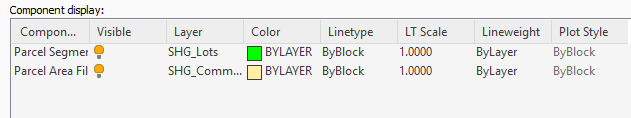

The parcel is hatchured from the Style Dropdown.
From the Civil3d files

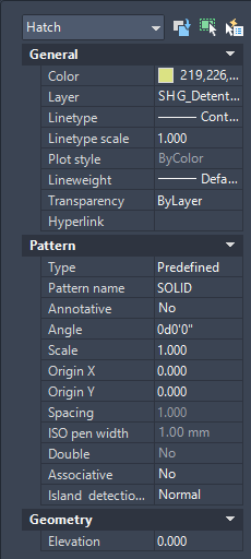

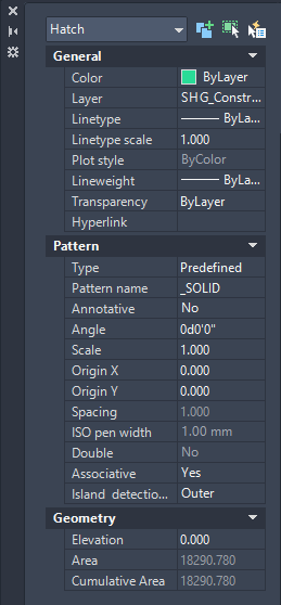

From the Autocad file after exporting via ExportC3ddrawing command
Hope this helps.  Dwg files attached.
At present out workaround is to copy the hatch areas to a new drawing then create new hatch boundaries.  Then delete the existing hatch and then hatch the remaining hatch boundaries to get the area and accumulated areas geometry information into properties.   Although this is easy enough given that each lot type is on its own layer it would be great if we could get that information when it is converted from a civil3d drawing to an Autocad drawing.

I use the HATCHGENERATEBOUNDARY command

When you click on the Acad...10 dwg what does property return as an object ? Bricscad its hatch. copy this to command line (entget (car (entsel "\nPick object")))
I get Pick object((-1 . <Entity name: 405fe300>) (0 . "HATCH")

This was done previously and results are as previous entry.  Autocad shows it as a hatch but there is no area or geometry associated with it.
As per GLAVCVS Civil 3d does not identify it as a hatch - It is a fill and does not have any geometry associated with it.

The hatch you posted in the ACAD-Drawing 10-Model has a boundary made up of several separate polylines, you could join them and get a closed polyline boundary.
Expand
It is the hatch that I require to show the area geometry, not the polyline.
