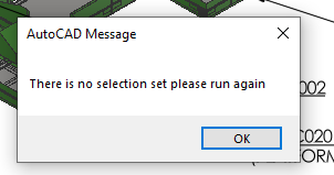

SORRY THIS RESET MY OSNAPS!! AFTER I END TO USE THE CODE!
try this code.
it is with out error trap - it looks for errors by checking the selection set and the object properties:
(defun c:MLeaderWBlname( / osnp tm tagname ptms ss ensel obj obj1 ifobj nam)
 (setq osnp (getvar "OSMODE"))
 (setvar "OSMODE" 0)

2 minutes ago, jim78b said:
you select an empty space
now work after restart autocad but sometimes the osnap reset all my settings
see attached code and video.
EXIT WITH ENTER TO RESTORE OSNAP.

         (alert "There is no selection set please run again")
         (setq ifobj 0)
