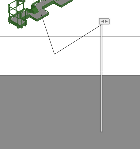

jim78b Posted Wednesday at 09:50 AM Author Posted Wednesday at 09:50 AM i need a mleader with a field in layout that update if the model change Quote
aridzv Posted Wednesday at 10:11 AM Posted Wednesday at 10:11 AM (edited) works for me... see attached code (changed the condition on the WHILE loop so the error trap no longer needed on regular exit) and screenshot video. (defun c:MLeaderWBlname( / *error* temperr osnp tm tagname ptms ss ensel obj obj1 nam);ptps ptps1 (setq temperr *error*);store *error* (setq *error* trap1);re-assign *error* (setq osnp (getvar "OSMODE")) (setvar "OSMODE" 0) (setq tm (getvar "TILEMODE")) (princ "Select object in paper space,select start point of MLeader,exit with esc'") (while (getpoint) ;;get point in paper space on the target object (if (= tm 0);if in paper space (progn (command "._MSPACE") (setq ptms (cadr (grread t)));;get the point where the cursor is on the target object in model space (setq ss (ssget ptms));;selction set of the object crossing the ptms point (setq obj(ssname ss 0)) (command "._PSPACE") );progn (progn ;in model space (setq ensel (entsel "\nSelect Block: ")) ;select the block object to copy (setq obj (car ensel)) ;set the block object to varaible );progn );if (setq obj1 (vlax-ename->vla-object obj)) (setq nam (vlax-get-property obj1 (if (vlax-property-available-p obj1 'effectivename) 'effectivename 'name ) ) ) (command "_mleader" "H" pause pause nam) );end while (setq *error* temperr) (princ) ) (defun trap1 (errmsg) (command "._PSPACE") (SETVAR "OSMODE" osnp) (princ) ) Recording 2025-03-26 120904.mp4Fetching info... Edited Wednesday at 10:25 AM by aridzv Quote

jim78b Posted Wednesday at 01:34 PM Author Posted Wednesday at 01:34 PM ok thanks ! has to do with arrow styles i think, because if i use standard it seem works! I'm asking too much if it could be made associative? If I change the name of the block, does the name linked to the arrow automatically change? I can't find anything on the net Quote
