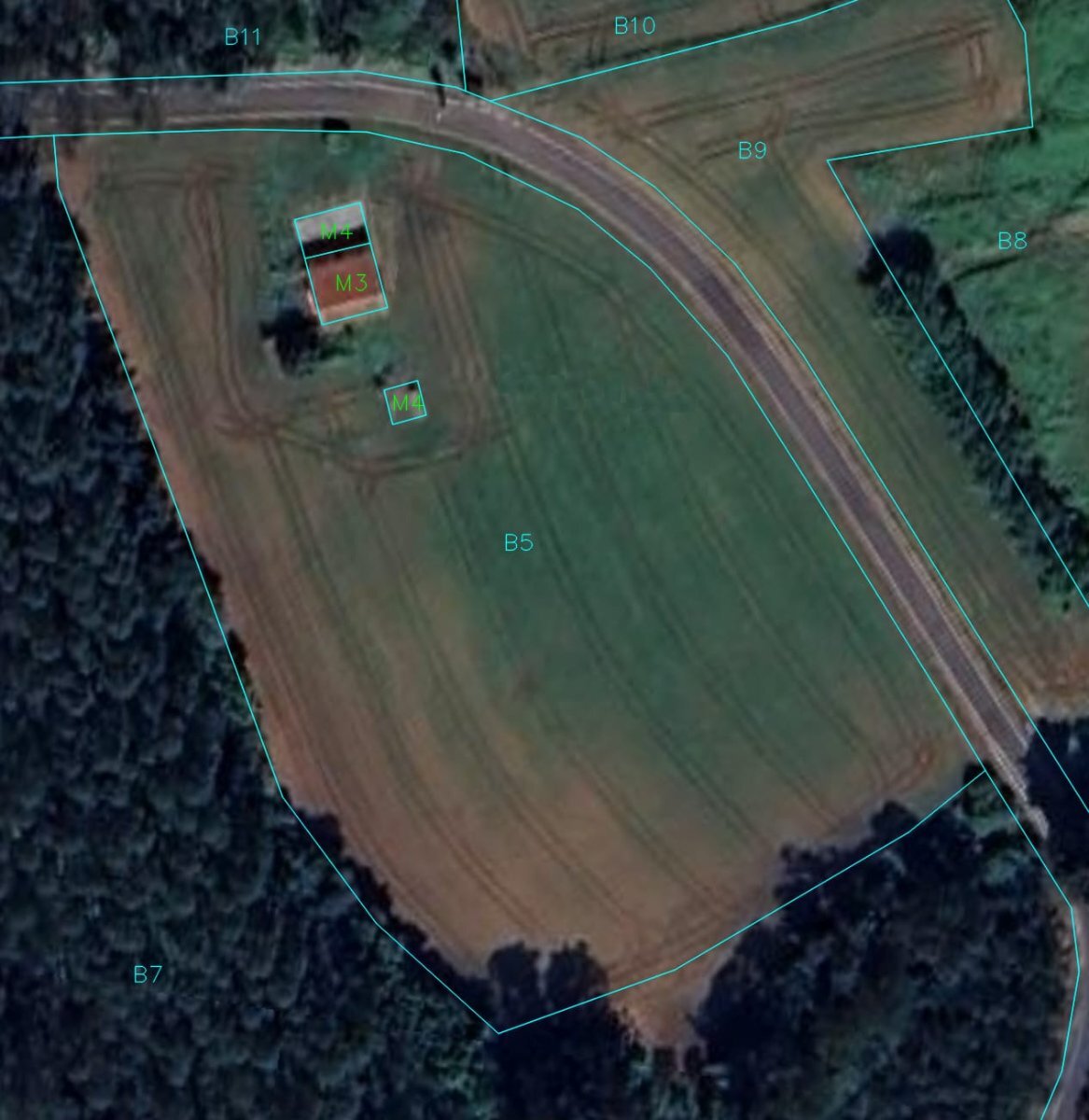

Hello everyone, and thank you in advance.
I have over 900 parcels made up of closed polylines and some with other closed polylines inside. Each parcel contains a text label. My version of AutoCAD is standard. I've seen several threads on this forum address this issue recently, and I'm wondering if it's possible to adapt some of that code for what I want to do: calculate the area of each perimeter and somehow associate the area information with its label. I've attached an example image.
I appreciate any help in advance and wish you a nice day.

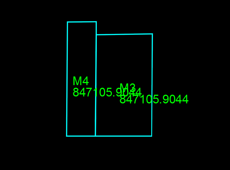

@LanloyLisp Thank you very much for your help.
But unfortunately, it doesn't calculate any of the areas correctly. Not even the largest polyline, because its area must be the difference between its area and the interior perimeters. And the areas of the interior polylines aren't correct either.
Any idea what's going on?
hmmm. strange. by the way, M4 is not a closed polyline, so it was excluded from the iteration, resulting in the same area as the largest one. I'll try to fix it this evening

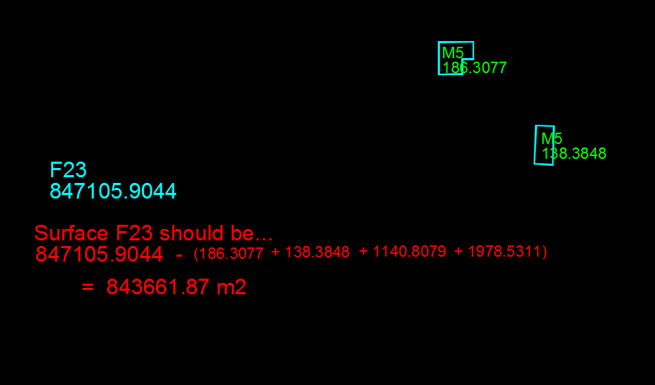

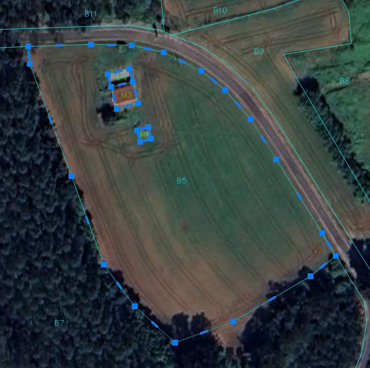

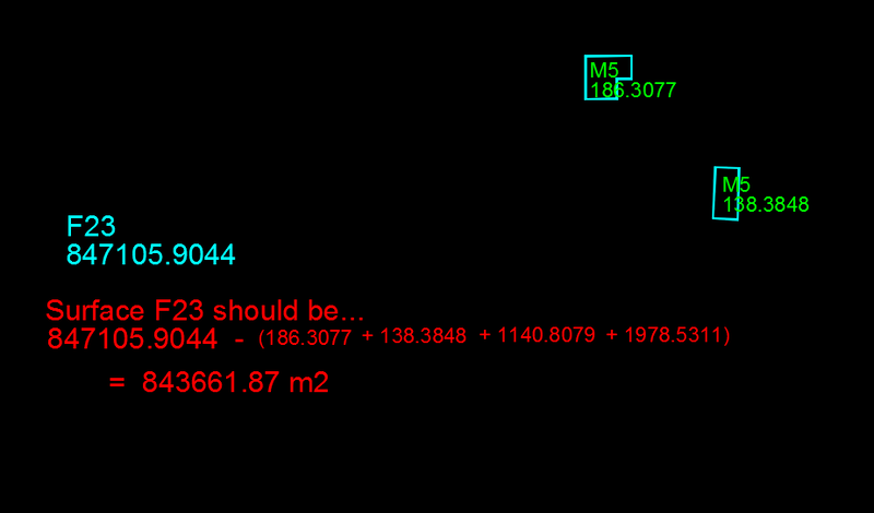

@LanloyLisp Thank you very much for your effort. I really appreciate it. Yes: There is indeed some polyline that isn't closed. That's how the drawings were delivered to us. But this has an easy solution.
I've been testing your Lisp. Now the small polylines do calculate their area correctly in the example I attached. But you don't subtract the area of the small polylines from the large polyline. I've attached an image below that explains this.
There's another problem: in a drawing where closed polylines overlap their neighbors, selecting the polyline you want to calculate is often difficult because the wrong polyline is often selected. Isn't it possible for the command to do the work on the entire drawing without having to select them one by one?

Hey @PGia,
Try this new one:
; Functions     :  UMTXT
; Description   :  Adding an Area value to the label/text of each closed polyline
; Author        :  SAXLLE
; Date          :  March 20, 2025
; Update 1.0    :  Added a substraction to get a total value of largest closed polyline
; Update date   :  March 21, 2025

I'v been tested this new one lisp on the both drawing which are you uploaded, and get great result (picture 1 and picture 2).
Picture 1.
Picture 2.
I hope you will get satisfied. 🙂
Notice: It will only concate the label/text value of closed polyline with an Area of that closed polyline, for opened polylines, nothing is going to happen.
Best regards.
Edited by Saxlle
Added a Notice. Updated code to get a total value of largest closed polyline.
(defun c:pl_area (/ bb e h ll lst lst2 pt pts n nv q r ss sst str ta ur v
          raycast plineoff)
  ;;LeeMac
  (defun raycast ( p l )
    (= 1
        (logand 1
            (length
                (vl-remove 'nil
                    (mapcar
                       '(lambda ( a b ) (inters p (mapcar '+ p '(1e8 0.0)) a b))
                        (cons (last l) l)
                        l
  (defun plineoff	 (v off Out / e eng pts vs)
  (setq	e (vlax-vla-object->ename v)
	eng  (entget
		 (car
		   (vl-sort (setq vs (mapcar 'car
					     (list (vlax-invoke v 'offset off)
						   (vlax-invoke v 'offset (- off)))))
			    '(lambda (x y)
			       ((if out > <) (vla-get-area x) (vla-get-area y))
	pts  (mapcar '(lambda (x)(trans (cdr x) e 1)) (vl-remove-if-not '(lambda (x) (eq (car x) 10)) eng))
  (mapcar 'vla-delete vs)
  pts
  (if (setq e (car (entsel "\nSelect largest polyline: ")))
      (setq v (vlax-ename->vla-object e)
	    ta (vla-get-area v)
	    bb (plineoff v 1.0 T)
	    ss (ssget "wp" bb '((0 . "LWPOLYLINE")))
	    sst (ssget "cp" bb '((0 . "MTEXT,TEXT")))
      (if (eq (sslength ss)(sslength sst))
      (repeat (setq n (sslength ss))
	(setq n	  (1- n)
	      e	  (ssname ss n)
	      a	  (vla-get-area v)
	      lst (cons (cons a e) lst)
      (setq lst	(vl-sort lst '(lambda (x y) (< (car x) (car y)))) q 0 r (length lst))
      (repeat (setq n (sslength sst))
	(setq n	   (1- n)
	      e	   (ssname sst n)
	      lst2 (cons (cons v (vlax-get v 'insertionpoint)) lst2)
      (foreach a lst
	(setq q (1+ q)
	      eng (entget (cdr a))
	      pts (mapcar 'cdr (vl-remove-if-not '(lambda (x) (eq (car x) 10)) eng))
	      str (rtos (if (not (eq q r)) (car a) ta) 2 4)
	      ta (- ta (car a))
	(foreach pt  lst2
	  (if (raycast (cdr pt) pts)
	      (if (eq (vla-get-objectname (car pt)) "AcDbMText")
		(vlax-put (car pt)
			  'textstring
			  (strcat (vlax-get (car pt) 'textstring)
				  "\\P= "
				  str)
		(progn (setq nv	(vla-copy (car pt))
			     h	(* 1.3333 (vla-get-height nv)))
		       (vlax-put nv 'textstring str)
		       (vlax-put nv
				 'insertionpoint
				 (list (car (cdr pt)) (- (cadr (cdr pt)) h) (caddr (cdr pt))))
	      (setq lst2 (vl-remove pt lst2))
	(prompt "\nPolyline and text counts do not match. Check selection.")
here's my latest revision as well.
