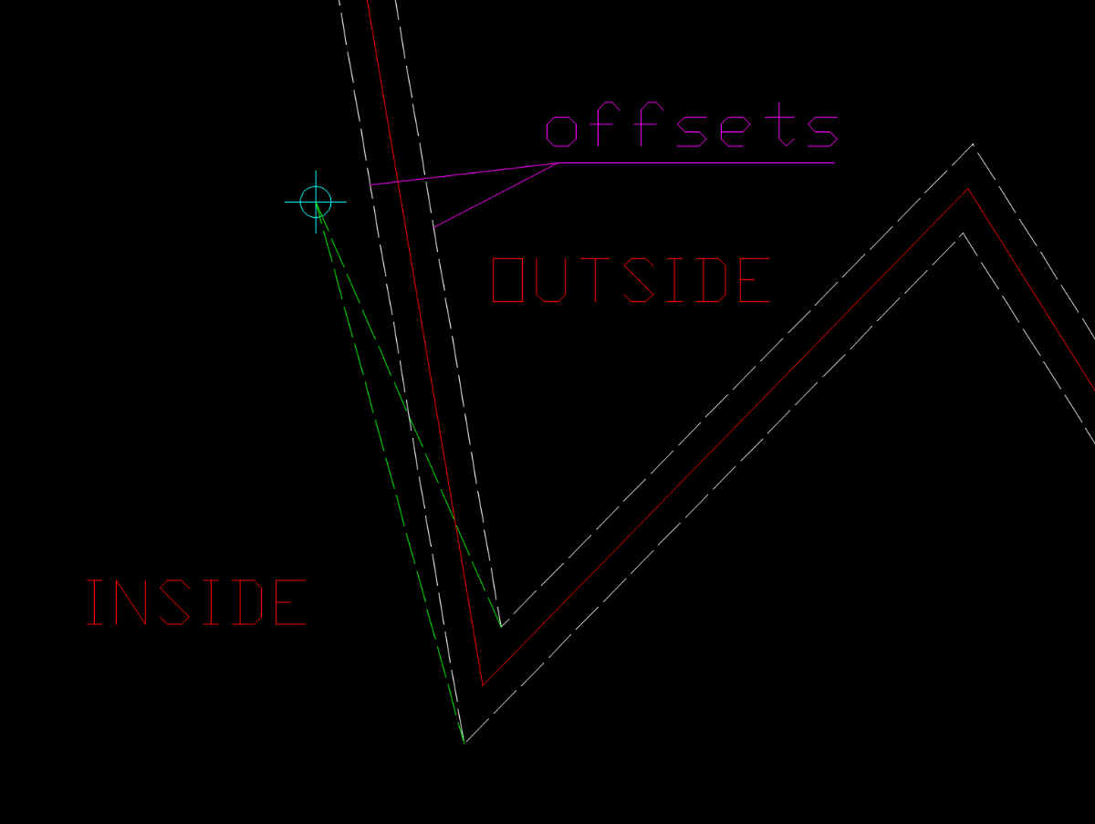

GLAVCVS Posted March 13 Posted March 13 On 3/12/2025 at 3:11 PM, Lee Mac said: https://www.theswamp.org/index.php?topic=47969.0 Expand This conversation is very interesting. Marko's concept is interesting. But it has two weaknesses: - If "boundary" doesn't work or works poorly (this often happens in complex drawings), the code fails. - If the point is close to the polyline and there are any odd vertices on the polyline, the following may occur in some cases: 1 Quote
GLAVCVS Posted March 13 Posted March 13 On 3/12/2025 at 3:11 PM, Lee Mac said: https://www.theswamp.org/index.php?topic=47969.0 Expand And your approach of using an X-ray is a very good idea. It hadn't occurred to me. But, above all, the exception handling is flawless. Or at least, I haven't found any. My approach also works with intersections, but to the right and left of the reference point: - odd number of intersections to the right and left = interior point - anything else (after my exception handling) = exterior point. The difference between my approach and yours is that I would have used '(ssget "_F"...)' and would have searched for intersections by traversing the entire perimeter. But for this case, your approach is better. I'll try to adapt my idea as best I can so that it's not too worse than yours. Quote
