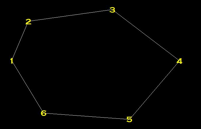

i'm just asking a little favor or help..for routine lisp for boundary point..which is i could select an option wether outer nums. or innner nums..generally clockwise rotation as shown in figure attached..also pickone corner for reference for numbering.

Oliver, my code just put a number on each on the vertices of the object you have selected.
I thought this is what you are looking for?
An example of the result of my posted code:
I thought this is what you were looking to achieve?
ok..i got it..but here is a little problem regarding the text size ht.
thanks
My code just uses the TEXTSIZE variable as set in your drawings - what size would you like it?
Going by the TextSize as quoted in your drawing (3):
