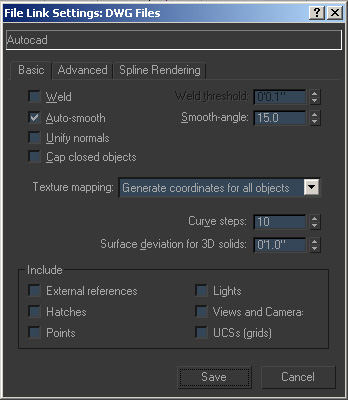

curved items from acad come out segmented??
using file link into max, and my curved panels come out segmented, sort of like how curved items are in autocad before you hit viewrez.
the panel is 1m high and is about 1.3m wide with a 1.9m radius.
what setting in file link or max have i missed.
thanks

There are options in the File Link Manager that allow you to tell Max how to handle the models imported from Autocad. You just have to dig around in there to find them. If you can post some screen shots of your import options I can try to walk you through it, but that's the best I can do until I get my computer issues sorted out.

got it, dont know how, but it works and looks correct, and has been saved as a file link default. thanks to everyone for their input.

Glad you got it sorted. Below are my Link Manager settings. You can increase the "Curve Steps" and decrease the "Surface Deviation" for smoother results.

i think i missed the preset drop down after making the changes and then the file never imported with the new settings, hence me loosing the plot, then hitting the help section and then finally realizing what i had not done.

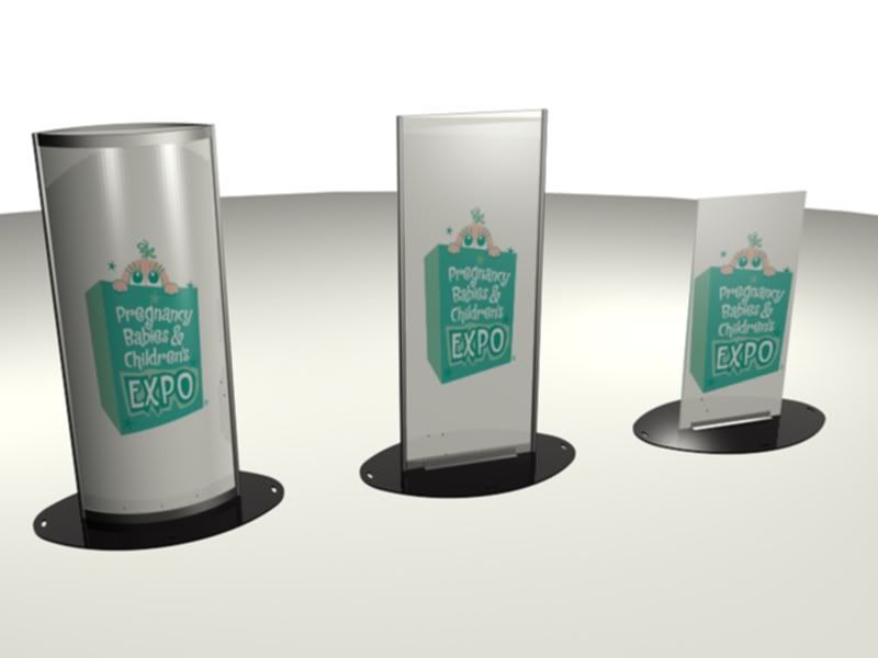

more tweeking needed, but is better than the first pic.

It's looking pretty good. You might want to turn the self illumination up on the image maps though, to make them brighter.
