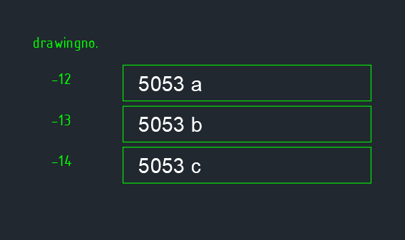

Is there a way to update a letter tag "incremental" in a block in multiple drawings?
"5053 a" is going in one drawing, "5053 b" in another and so on....

Yes, the block is already in the drawings and I want to change them without opening them.
No, the drawings doesn't necessarly have corrosponding number/letter. Letter "a" can be assigned to drawingnumber -125, "b" to -131...., but mostly the are at least in a streak.

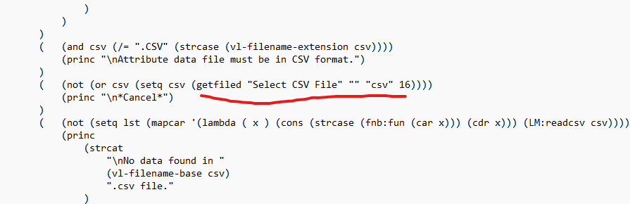

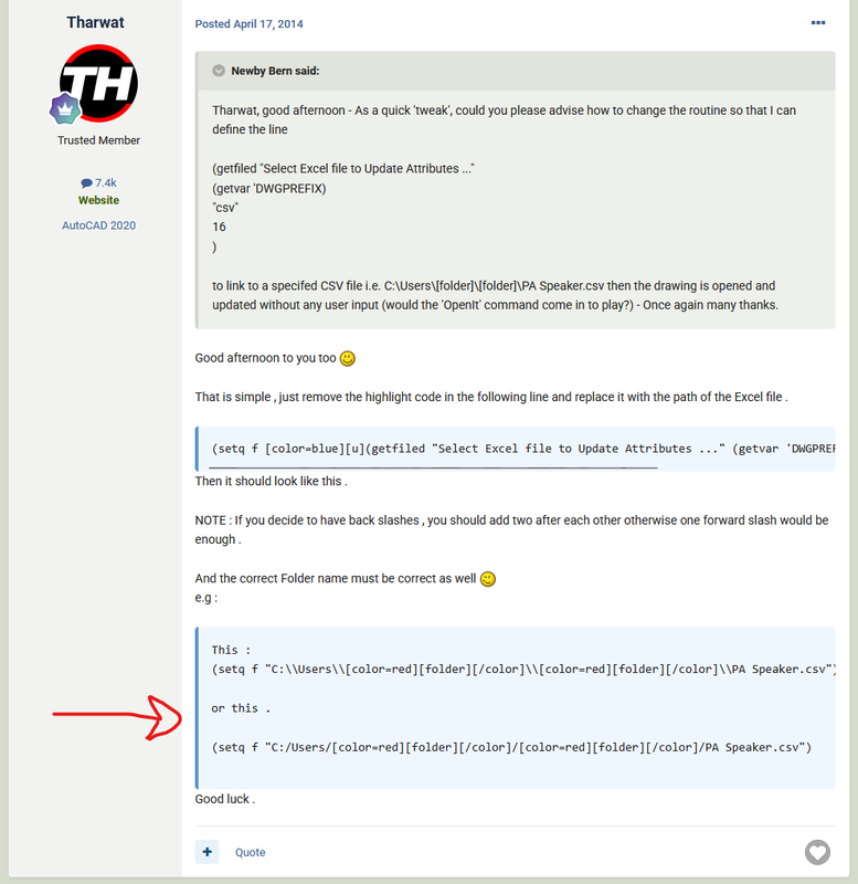

Is there a way to choose the file search path automatically? To write in the path in the lisp code?

;; Location of CSV Drawing List (set to nil for prompt)                 ;;
;; If the CSV file resides in the same directory as the drawing, omit   ;;
;; the filepath from the location of the CSV file, and only include     ;;
;; the filename, e.g. "myfile.csv"                                      ;;
;; If only a filename is specified, AutoCAD will first search the       ;;
;; working directory for this file before searching the Support Paths.  ;;
    (setq utb:csv nil) ;; e.g. (setq utb:csv "C:/myfolder/myfile.csv")

I found the answer here:
The script now works, but a bit slow.
Is there a smarter way to do this?
That's not correct - you should use the utb:csv parameter defined at line 126 of the program:
Just a comment it looks like in the image you have the values in Excel so you can read current open Excel Cells directly without having to make a CSV. In Lee's code you read a line, in a Excel code you would read 3 Cells via a Row & Column values. Yes can hard code the lisp to open the correct Excel.
