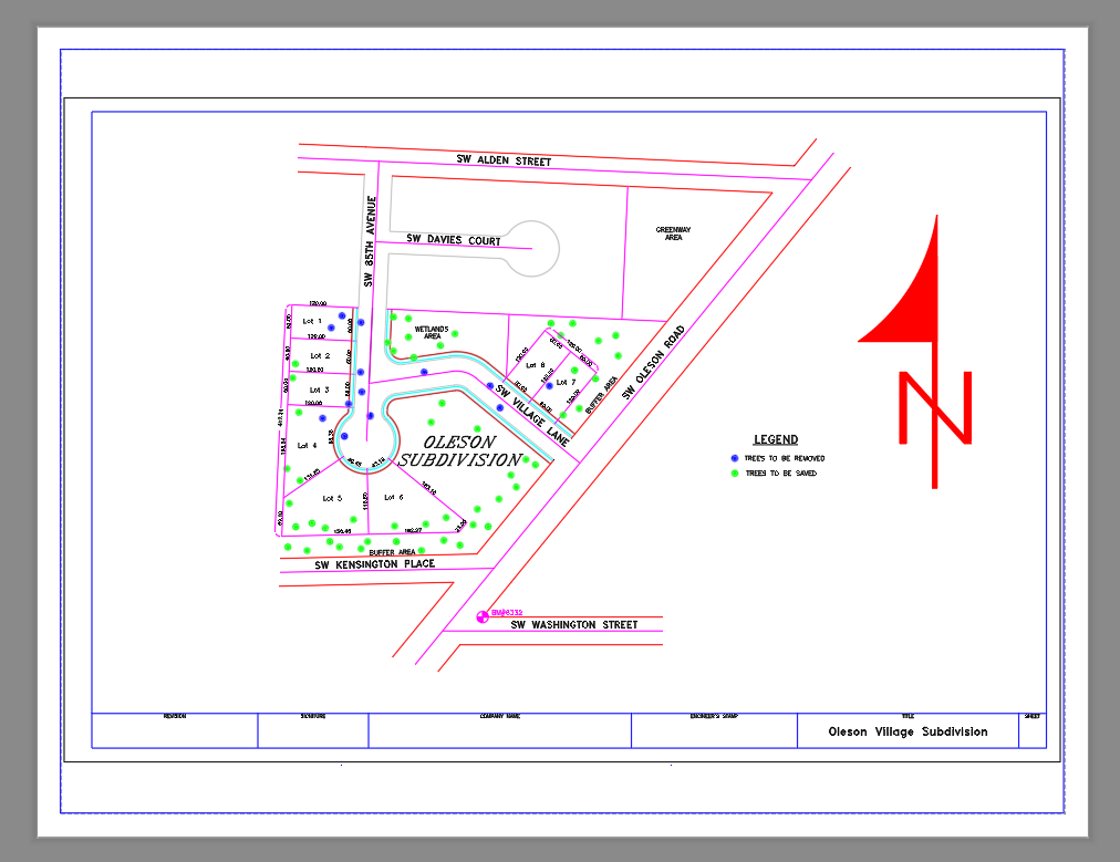

Ztrain Posted February 27 Posted February 27 (edited) As if taking nearly a week to do a project I nearly completed in a day wasn't enough to not make a person melt down. I can seem to find zero help on the internet as to how to add a bar scale to a 2d drawing. And man I know I'm asking for the moon and the stars here but making that N symbol rotate with the drawing would be cool too. But for right now I just need to turn this in. I'm not looking for a handout like some other shady folks on these message boards I actually want a mastery of the subject matter. The simple fact is: In this program, we are not TAUGHT a THING. Please if you both a) not a Penn Foster worshiper just on here to troll on their behalf, and b) can find it in your heart to help me, I would be forever grateful. I very much, would appreciate if someone could tell me, without skipping steps: 1. How to add a bar scale to this drawing. 2. How to make my N symbol move with the drawing like I "think" it's supposed to. 3. And how to set my (lineweights..?) correct so they show up correctly in paper space as they do in model space. For example my center lines on the road are "Center" as instructed and appear so in Model space. But BAM move to paper space and they are continuous. Thank you for reading. Zach Edited February 27 by SLW210 Deleted Drawing File Quote

ReMark Posted February 27 Posted February 27 (edited) Please consider removing the attached drawing. Why, you ask? Simply because another student could download it, make a few minor edits then pass it off as their own thus skipping all the work and getting a major perk (i.e. - a completed drawing for no significant effort). Just a suggestion; not a criticism. Now to your questions. 1. You can either create a bar scale or find and download a bar scale block from an AutoCAD block sharing website. 2. The only way your north arrow is going to move with your drawing is if it is located over in model space. I believe it currently sits in paper space. 3. Lineweight (how thick a line appears when viewed or printed) is different than linetype scale which is the issue I think you are asking about. Yes or No? Here is something you can try first. Set LTSCALE to 1. Set PSLTSCALE to 1. Set MSLTSCALE to 1. Use the REGEN command to update the display. Re: bar scale. I believe I may have provided either an image or possibly even a block in one of the threads regarding the Oleson Village project. Take a look at the thread titled: Penn Foster Student Suffering with Oleson Village Map!!! Edited February 27 by ReMark Quote
