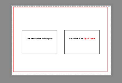

I want to create a viewport in the space of a layout, the dimensions of which are equal to the specified polyline frame.
But I get an error.
Select a polyline: ; error: invalid argument type: consp <Object name: 7fffef13920>

Thanks, but the viewport is not being created in the sheet space, and the model space is divided into 4 viewports.
Maybe use
(setq pline (car (entsel "\nPick pline ")))
(setq pts (mapcar 'cdr (vl-remove-if-not '(lambda (x) (= (car x) 10)) (entget pline)))))
(command "Mview" (car pts)(caddr pts))
(command "Mspace")
(command "Zoom" "E")

How to make the viewport display what is in the frame?
Everything that is in the model's space gets into the viewport.

Ok once you make a viewport you need to zoom to a point inside Mspace, you can set the scale of the viewport also in this 2 step process.
(command "zoom" "C" (getpoint '\PIck center point ") 100)
(command "zoom" (strcat (rtos scale 2 2) "XP)
When you zoom C it sets the viewport centre point, using scaleXP ie 4XP resets the viewport scale but keeps the centre point.

But first, I would like to understand with a simple example how to get a viewport based on the selected frame.
For example, I have 3 frames in my model. I want to select one frame and get a viewport in the layout space that displays only the selected frame, not the entire drawing. And with the option to choose the scale.

You do it in reverse to what you asked. you enter scale 1st. Then draw a rectang that matches the viewport in the layout scaled up or down to match scale. The other way is just pick a pt and use  ZOOM C PT scale when in mspace use a dummy value for scale, then use zoom scXP the sc is simple for metres (setq sc (/ 1000 requiredscale) ) similar for mm a factor of 1000.

If I understand correctly, you want the 'LayOut' viewport to adapt proportionally to the selected rectangular polyline to display, by zooming, its content?
  • Thanks 1
Yes, that's right.
