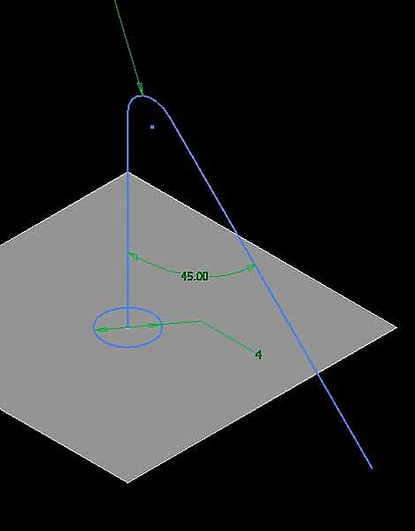

hey guys, im new to inventor and im wondering if there is a way to make like 45 degree bends in tubing and things like that, thanks for the help
There must be several dozen methods depending on design intent. Everything from a simple Sweep of 2D Sketch to AutoBend in 3D Sketch to Routed Systems.
You might get an appropriate suggestion by attaching what you have so far.
I recommend going through the Inventor tutorials in my signature.
Like JD said,lots of ways to do this.

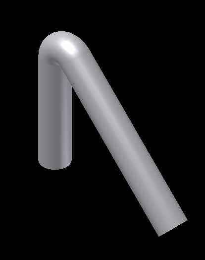

The example above shows a very commom way to do it via the sweep, another that was introduced to 2008 is the bend command.
