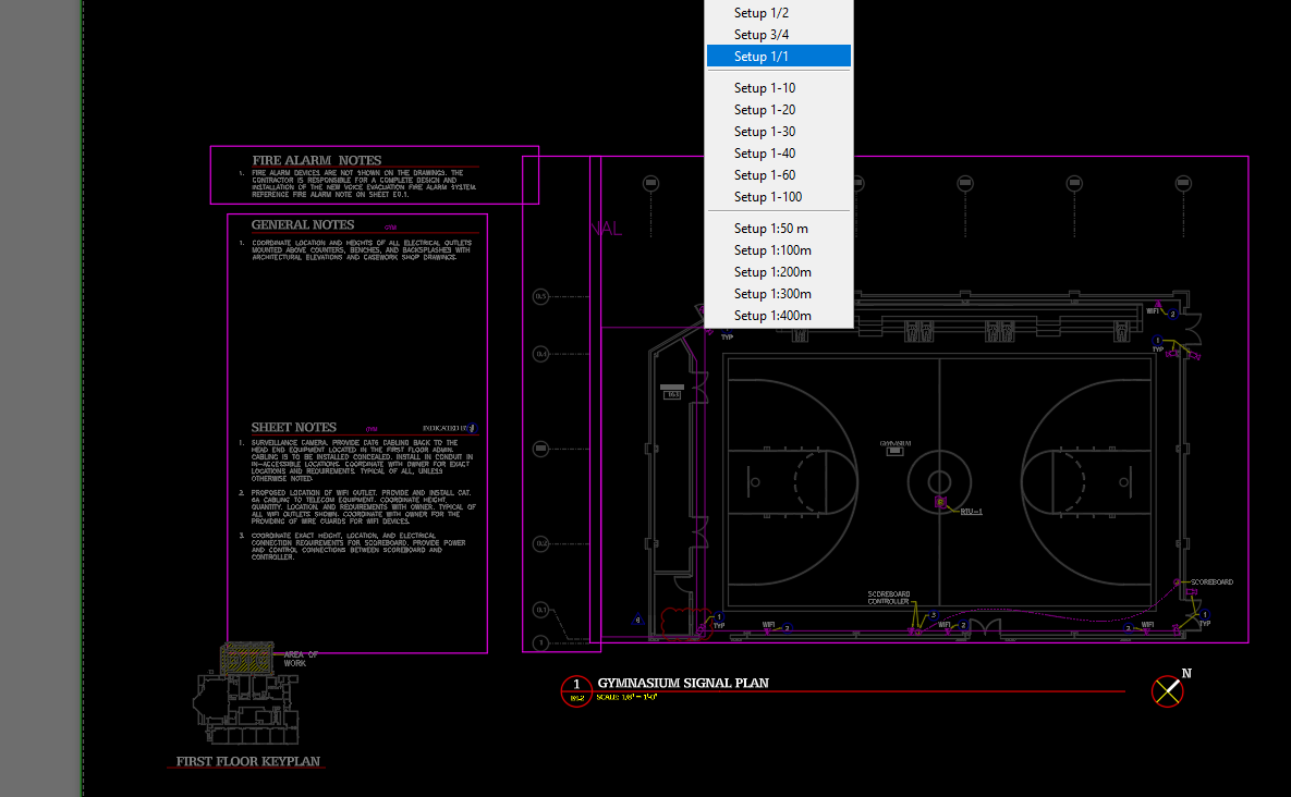

Jared A Posted Wednesday at 07:11 PM Author Posted Wednesday at 07:11 PM when on the layout page, we set the scale back to 1:1 with nothing selected so that the x-referenced drawings will show correctly, i.e. dashed lines, hatching, etc. this does not change the scale of the viewports which are sometimes set to 1/4 or 1/8 scale. on our shortcut commands it says "setup 1:1", not sure if that helps. Quote

Jared A Posted 18 hours ago Author Posted 18 hours ago PSLTSCALE is on, I checked. Our printer will do up to 22x34 but to save paper costs we print 11x17. Our drawings are set for a standard paper size of 22x34. Even when not printing, looking at the sheet shows lines solid when they should be dashed if the paper space isn't set to 1:1. Quote
Steven P Posted 18 hours ago Posted 18 hours ago I don't recognise the drop down list you have there - might be a setting I don't have turned on - or is that a custom button / macro / LISP (and if so.... are you able to post the details, might be something else going on in the background apart from scale at 1:1) Is it Annotation scale? (I think variable cannoscale does that) - you can replace: (vla-put-customscale (vlax-ename->vla-object (ssname MySS acount)) scale) ;; Set viewports scales line with whatever setting needs changing Quote
Jared A Posted 16 hours ago Author Posted 16 hours ago i got it figured out, this is what it is for reference: this used our variables we created years ago. Thank you for your help. ^C^C._ZOOM;_E;_fillet;radius;0.0625;chamfera;0.0625;_chamferb;0.0625;dimasz;0.0625;dimcen;0;dimdli;0;dimexe;0.0625;dimexo;0.0625;dimgap;0.0625;dimtxt;0.1;donutid;0;donutod;0.5;gridunit;1,1;hpscale;0.25;hpspace;0.25;ltscale;0.208;offsetdist;1;snapunit;1,1;textsize;0.1;dimclrt;7;limits;0,0;36,24;dimscale;1;_chamfera;0.0625;chamferb;0.0625;dimasz;0.0625;dimcen;0;dimdli;0;dimexe;0.0625;dimexo;0.0625;dimgap;0.0625;dimtxt;0.1;donutid;0;donutod;0.5;gridunit;1,1;hpscale;0.25;hpspace;0.25;ltscale;0.208;offsetdist;1;snapunit;1,1;textsize;0.1;dimclrt;7;limits;0,0;36,24;getvar;dimscale;1;_QSAVE;$M=$(if,$(eq,$(getvar,DWGTITLED),0),~);._CLOSE; 1 1 Quote
