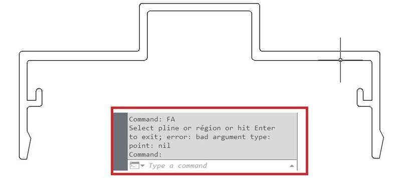

anouar Posted Tuesday at 08:16 AM Author Posted Tuesday at 08:16 AM 15 hours ago, didier-acadlabs said: Bonjour@anouar L'exemple de dessin que vous nous donnez est compliqué à faire ce que vous demandez. En effet, un cercle dans un autre n'est pas un exemple trivial pour calculer le périmètre. Vous travaillez toujours avec cette forme ? Pour l'aire : pas de soucis. Pour le poids : pas de soucis. Pour le périmètre : quasi impossible. Amicalement hello no I work on aluminum profiles of different shapes each time I have to calculate the surface and the perimeter and the weight of an object after subtraction attached another form please help me I have a lisp which is good but does not calculate the weight by the formula (surface * 2.7) / 1000 also is not applicable on the object that is to say after subtract essai 2.dwg Polylin Area & Length FA.LSP Quote
didier-acadlabs Posted Tuesday at 02:30 PM Posted Tuesday at 02:30 PM Bonjour @anouar Here is what I propose Amicalement Anouar-CadTutor.lsp Quote

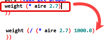

didier-acadlabs Posted yesterday at 10:16 AM Posted yesterday at 10:16 AM Bonjour @anouar I don't know if you are interested in my proposition, but it is certain I made a mistake in. I forgot to divide by 1000 for the calculation of the weight. Are you able to fix the problem ? Or do you need help ? Amicalement Quote

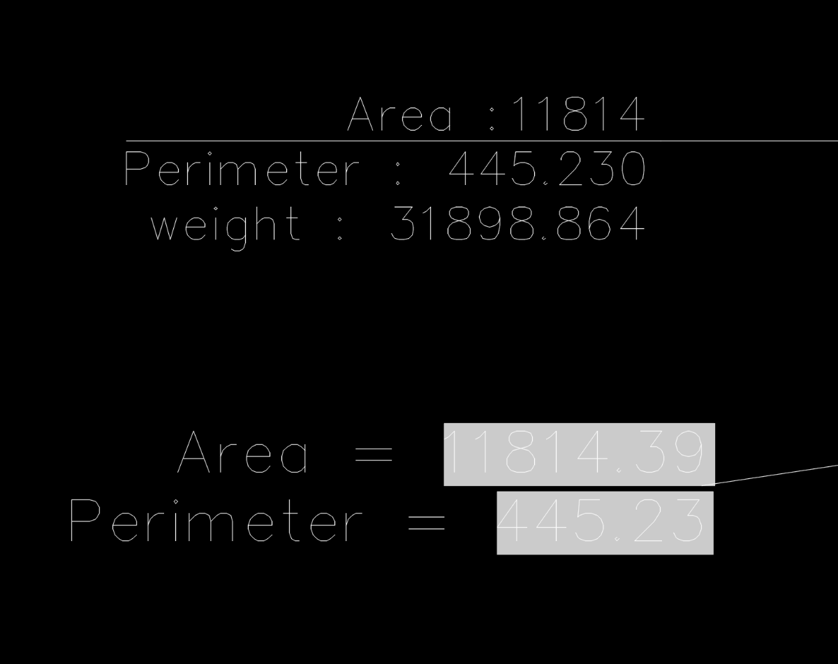

GLAVCVS Posted yesterday at 10:22 AM Posted yesterday at 10:22 AM @didier-acadlabs I think there is a small problem with that: the result of the operation should be displayed highlighted as the area and perimeter Quote
didier-acadlabs Posted yesterday at 10:34 AM Posted yesterday at 10:34 AM Bonjour @GLAVCVS I don't understand your message. Where is the "small" problem ? Have you read my solution? If this is the case, you understand that this line I correct is part of a general (setq) Amicalement Quote
GLAVCVS Posted yesterday at 11:07 AM Posted yesterday at 11:07 AM (edited) In Anouar's code, numerical calculations are shown in highlighting. If this is important, you may need to change something in your code. 4 minutes ago, GLAVCVS said: @ didier-acadlabs Edited yesterday at 11:09 AM by GLAVCVS Quote
didier-acadlabs Posted yesterday at 11:15 AM Posted yesterday at 11:15 AM Bonjour @GLAVCVS Yes, it is the case, but the fields are only interesting when it is possible to modify the entity and therefore change the value of the field. With the calculation of weight, it becomes more complicated. So I made the choice to work with text and not with fields. Because regions are not entities that can be easily modified. I am waiting for the answer of @anouar He will say whether it is correct or not. Amicalement Quote
