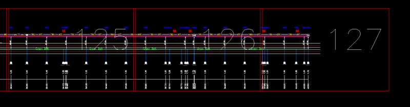

i required help for creation of automatic layout for my current file can anyone help me

Look at this image its make rectangs at scale matching a title block, then step 2 is select all rectangs and layouts are made. It was made automatically by just picking a pline representing center of road. So in your case just a horizontal line.
Do you use different size title blocks or only the 001 layout, is it A1 size ?
size is A3 and scale is 1000
Ok the layout is wrong the title block should be true A3 ie 420x297 at a 1:1 scale then make the layouts should be able to do something. Watch this space.
can you use my layout dimensions
Getting there slowly. Do layouts next.
Not sure about sheet size and are layout names always like 001 002 ->099 -> 100 101 etc. Please confirm.
I have plot layouts lisps but the layouts must be set up correctly to use. Same with filling in details, sheet number etc.
Latest update yes its working but answer my questions about sheet size and layout names.
yes all the sheet numbering are 001 002 ->099 -> 100 101 till the last chainage and one chainage are common in every layout which is start chainage of next layout like match line
