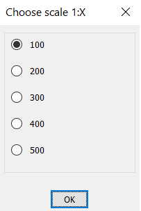

I have posted this many times you can make the dcl code and get an answer with like 4 lines of code. Have a look at examples in top of code.
Something like this is displayed.

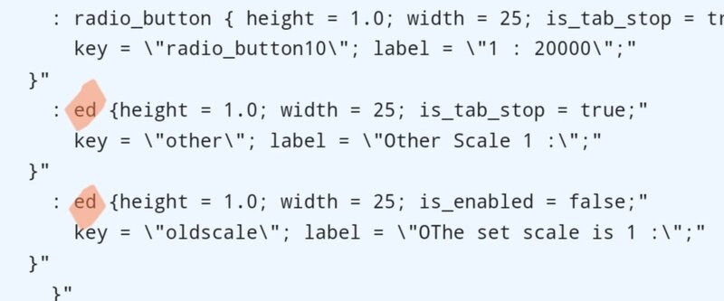

Anyway I dont think this line is correct.
"ed : edit_box { alignment = left; width = 25; edit_width = 10; fixed_width = true;}"
I would use :boxed_column

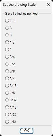

Attached is the latest working file.
One improvement would be to have the scales read with the proper feet and inch symbols.
Had trouble with the syntax.
For example, for scale 6 ... would  be better to read as 6" = 1'-0".
Keep in mind I am still a newbie to lisp, but usually can figure things out enough to get results.
Any suggestions are welcome.
SETSC.lsp
As I work metric not a problem. 1:100 etc I have tried to add the " but the dcl very much rejects the double quote. Ok I remembered what I did you use dbl single quotes  ' '. Ok a hidden hint you can use the full string "6'' = 1'-0''" in your cond or the variable BUT contains the button number selected makes the cond ((= but 1)(dosomething)) a simpler way of setting in this case the scale.
(ah:butts but "V" (list "Choose a number" "6'' = 1'-0''" "3'' = 1'-0''" ..........))
