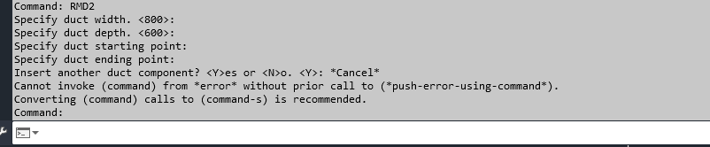

i have some issue in the AutoLISP program, which i used from in this form, really good
It works well for me, but I have an issue with some error when I use the escape (Esc) button on the keyboard to cancel the program. I lost my OSNAP mode 0; the OSNAP did not restore the previous mode. At the same time, if I am close by the exit program, its working properly. I dont know why
and I try to solve some error set RMD2_SET somewhere in the MF code, but my bad luck, its not successful.
so please, someone help me to sort out the problem Very helpful

hi gentlemen, Thanks for your reply. and i thanks to mr. buzzard making this program for hvac duct drawing really great
Actually, i went to the page but i didn't get the problem of my issue is that I get the code from the page which you shared link,
after using the AutoLISP, i noticed the problem just few months before
the program working well there is no issue
but when I'm using the program, i abort or cancel the function by escape button; i lost my osnap mode
so how can i solve the error control in the main function
thank you

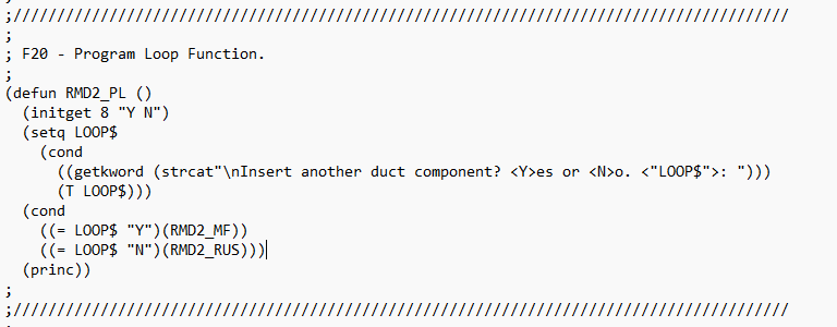

3 minutes ago, rahil40 said:
; F20 - Program Loop Function.
(defun RMD2_PL ()
  (initget 8 "Y N")
  (setq LOOP$
    (cond
      ((getkword (strcat"\nInsert another duct component? <Y>es or <N>o. <"LOOP$">: ")))
      (T LOOP$)))
  (cond
    ((= LOOP$ "Y")(RMD2_MF))
    ((= LOOP$ "N")(RMD2_RUS)))
  (princ))
hi brother
if i am using yes no condition the program works
sometime accidentally press escape button. I am facing the problem
i need to know the after-loop yes/no condition
need for cancel or console break operation code something
thank you
44 minutes ago, rahil40 said:
@rahil40 OK - find the function "RMD2_SET" (or "RMD_SET" in the V6 version) in the lsp file and make the following change. Try it and let us know if that did the trick:
(defun RMD2_SET (ERRORMSG)
  ;(command nil nil nil) ; <--- Comment this out by leading it with a semi-colon
   (command-s)(command-s) ; <--- Add this line
  (if (not (member ERRORMSG '("console break" "Function cancelled")))
    (princ (strcat "\nError:" ERRORMSG)))
  (if SUS (mapcar 'setvar SUS_LIST SUS))
  (princ "\nAttention!....A user error has occurred.")
  (princ "\nThe program will now restore the user settings and exit.")
  (terpri)
  (setq *error* TERR$)
  (princ))
(EDIT: Tested and corrected earlier replacement)

Good morning, brother.
I want to thank you very much for saving my time. Your code is working. I tried it before in both the main and loop functions, but it didn't work for me.
Sincere gratitude, fantastic
heartly thanks 🥰
