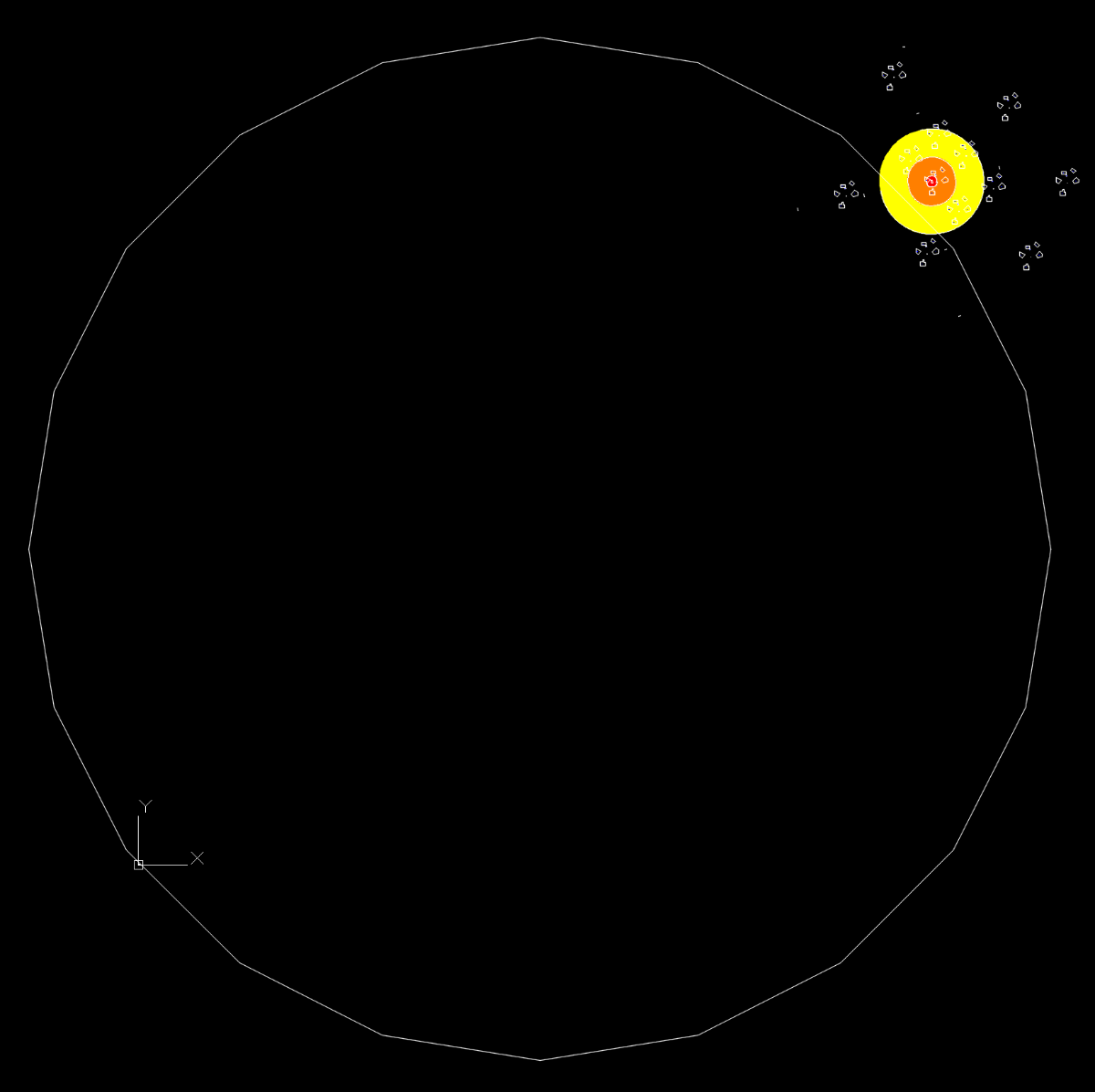

It's interesting
But, at least for me, it doesn't work correctly.
I've drawn a polyline with the points that the function calculates when selecting the yellow circle and this is what I get:
And if the hatch has several arcs to compose an irregular shape, it doesn't work well either.
In the following image you can see the perimeter returned by the function when the cyan hatch is selected.
It is interesting to note that all the perimeters returned by the function seem to want to pass through the point 0,0
Furthermore, the function in no case returns the inner perimeter

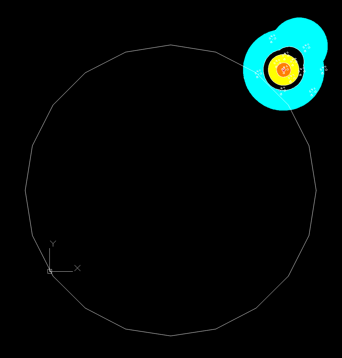

This should be helpful when you trying something to select inside the CIRCLE (like from attached example file).
(setq ent_circle (car (entsel "\nSelect the CIRCLE:"))
      num 50 ;; number of times to repeat inside "repeat" function. Can be changeable, depends of density between the points.
      ang 0.0 ;; default angle
      tot (+ pi pi)
      inc (/ tot (float num))
      cen (cdr (assoc 10 (entget ent_circle))) ;; CIRCLE base point
      rad (cdr (assoc 40 (entget ent_circle))) ;; radius of the CIRCLE
(repeat num
  (setq lst (cons (polar cen ang rad) lst)) ;; creating a LIST with "points" on the CIRCLE
  (setq ang (+ ang inc))
(setq entSelection (ssget "CP" lst '((0 . "LWPOLYLINE")))) ;; make a selection set from previous list of points (lst). SSGET filter can be changed
After executing the code, you will get this (picture 1). I changed the color into to the orange, just to make it easier to see all polylines.

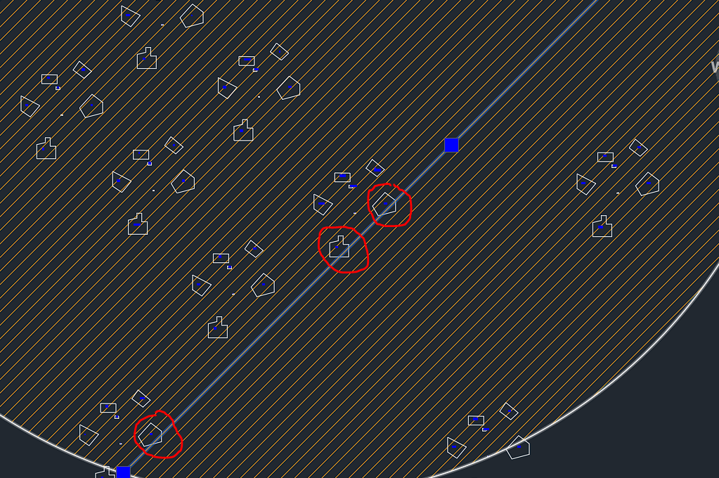

Maybe the second approach can be also helpful.
(setq entOne (car (entsel "\nSelect the first HATCHED area:"))
      objOne (vlax-ename->vla-object entOne)
(vla-getboundingbox objOne 'minPtOne 'maxPtOne) ;; get the boundingbox from hatch
(setq ptMinOne (vlax-safeArray->list minPtOne) ;; get the lower left point
      ptMaxOne (vlax-safeArray->list maxPtOne) ;; get the upper right point
(if (not (tblsearch "LAYER" "TEST_BOUNDARY")) ;; this is just for testing
      (command "-layer" "m" "TEST_BOUNDARY" "c" 1 "" "s" "TEST_BOUNDARY" "")
      (command "clayer" "TEST_BOUNDARY")
(command-s "_RECTANG" ptMinOne ptMaxOne) ;; make a rectangle to wrap everything around the hatch
(setq entlastOne (entlast)
      objRectangOne (vlax-ename->vla-object entlastOne))
(setq coordsOne (mapcar 'cdr (vl-remove-if-not '(lambda (x) (= (car x) 10)) (entget entlastOne)))) ;; get the coordinates from previous maded rectangle
(setq ssOutside (ssget "WP" coordsOne '((0 . "LWPOLYLINE")))) ;; make a selection set from previous list of points (coordsOne). SSGET filter can changed
After executing the code, you will get this (picture 2). I changed the color into to the orange, just to make it easier to see all polylines and you will se a red rectangle which I get from boundingbox.
