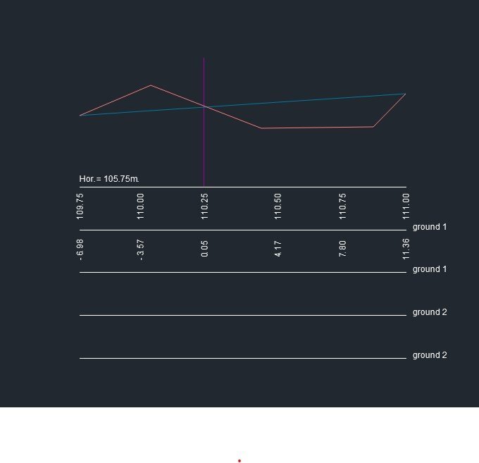

Hi I use this code to dimension cross sections. If move the cross section to  0, Datum Elev possiton the code works perfect. To avoid to move the cross section I add a command to move the ucs 0, Datum Elev in the place were the section exist. But the code gives me wrong values for  polyline coordinates. Can any one help me to transform the insert coordinates by the new ucs possition ?

Thanks
I think I fix the code but I is not. I update the code to calculate the coordinates correct

But now put the coordinates inwrong possiton
The previous code put the text in correct possition but have wrong coordinates

Can anyone help me to fix the code?

not sure if this helps let alone work because I have nothing to test (and 3D / trans is not my thing) but maybe it at least can inspire you. It could also be a case of just a few typo's :

          ;;; when / where is str used?

          ;;; is str the combined string for x / y and if so where is it useds?

    ;;; its says atof xstr but maybe    ystr? ................................................. str?

;;; best of both worlds : use points from 2nd posted routine and strings from 1st

    ;;; right coordinates (used other variable names to keep'm apart

Hi rlx . The code is too close to work. Now x coorsinates are set correct in the correct possition. The y coordinates is correct but in wrong possition.
Any other ideas how to fix the code. I attach  a dwg to test the code

I wasn't sure if I had to use ptx or pty in second command line so I changed it to pty but probably it so be twice ptx?
Hi rlx. Is it possible to do the same coordinate transformation , and fix the correct possition of the text to this code ?

        (action_tile "accept"
                     (strcat
                      "(progn"
                      "(setq index (atoi (get_tile \"dl\")))" ;; Get the selected value from the list
                      "(done_dialog) (setq userclick T))"))
        ;; Action for the cancel button
        (action_tile "cancel" "(done_dialog) (setq userclick nil)")
        ;; Start the dialog
        (start_dialog)
        ;; Unload the dialog and delete the temporary DCL file
        (unload_dialog dch)
        (if (and dcl (findfile dcl)) (vl-file-delete (findfile dcl)))
        ;; If the user clicked OK, proceed with the logic
        (if userclick
              ;; Depending on the selected value, set the appropriate height
              (cond
                ((= 0 index) (setq dp 3.60))  ;; For "Φ.Ε"
                ((= 1 index) (setq dp 8.40))  ;; For "ΕΡΥΘ."
              ;; Layer assignment based on the selection
              (if (= index 0)
                  (command "_layer" "_m" "GRD1" "_c" "7" "" "")
                  (if (= index 1)
                      (command "_layer" "_m" "GRD2" "_c" "7" "" "")
		    ; Change UCS
    (setvar 'osmode 32)
    (setq pt (getpoint "\nChange UCS  select point: "))
    (setq v pt)
    (setq pt (list 0.0 Ycoord 0.0))
    (setvar 'osmode 1)
    (setvar 'dimzin 2)
              ;; Get points and place text on the drawing based on the user input
              (while
                (setq
                  pt1 (getpoint "\nSelect point on polyline:")
                  x (car pt1)
                  y (cadr pt1)
                  xpti (- baseh dp) ;; Calculate the x distance
                  ypti (+ xpti 2.40) ;; Calculate the y distance
                  pt2 (list (car pt1) ypti 2.0)
                  pt3 (list (car pt1) xpti 2.0)
				  (command "style" "PMSF-TEXT 2" "Arial" "" "" "" "" "")
                 ;; Format x and y as "0.00" if they are 0
                 (setq x (if (= x 0) "0.00" (rtos x 2 2)))
                 (setq y (if (= y 0) "0.00" (rtos y 2 2)))
                ;; Place the text at the calculated points
                (command "text" "mc" "_non" pt2 "0.35" "0" y)
                (command "text" "mc" "_non" pt3 "0.35" "0" x)
              ); while
   (setvar 'osmode 0)
   (vl-cmdf "_.UCS" "_W")
Thanks
