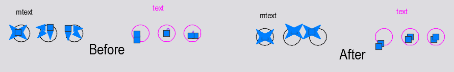

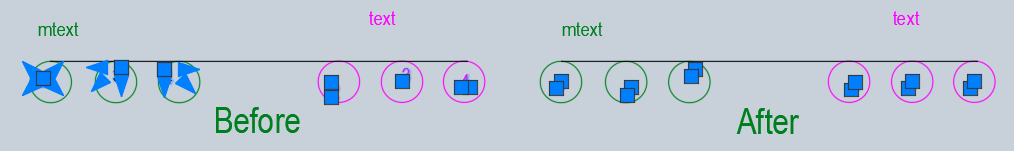

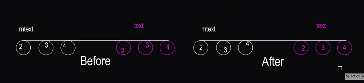

I would be very happy if someone could help me combine two lisps into one.
The code needs to select several mtexts and texts in circles using the frame, and combine the center of the texts and circles.
The mtext needs to be explode and change the alignment to mc.
;; 1 code for texts and circles
;; Text 2 Point - Lee Mac 2012
;; Prompts for a selection of Text and Point entities and moves
;; each Text entity to the nearest (2D distance) Point entity in the set.
;; https://www.cadtutor.net/forum/topic/37515-moving-text-block-to-adjacent-point/#comment-306285
;; Retains existing Text elevation.

  On 2/14/2025 at 11:03 AM, Nikon said:
Me parece que su código es un poco complicado, probablemente haya una forma más fácil,
como el programa Text 2 Point de Lee Mac.
;; Solicita una selección de entidades de Texto y Punto y mueve
;; cada entidad de Texto a la entidad de Punto más cercana (distancia 2D) en el conjunto.
;; Conserva la elevación de Texto existente.
(defun c:txt2pt....
La opción <Sí> no funciona aquí:
¿Quieres analizar círculo por círculo? [ N o/< >]:
Los textos están posicionados incorrectamente.
Expand
I just ran the code on your drawing and it works fine.
The first video shows the option to run the code on all affected circles and texts, without asking the user.
The second video shows the option to have the user confirm (by pressing 'Y', ENTER or 'K' to skip), circle by circle, whether the text to be moved is correct.
This option may be useful in some cases.
Anyway, I have changed the code to override the "OSMODE" variable during execution, just in case.
  • Thanks 1
Expand
Yes, indeed, your code works. Thanks!

  On 2/14/2025 at 5:00 PM, ronjonp said:
Here's my take on it:
Expand
You guys write codes at the speed of light, I take longer to test...
There are no problems with texts, but mtexts with crooked formatting are converted into attributes of this type:
Edited by Nikon
