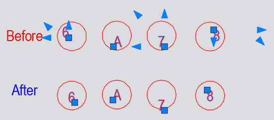

I want to get a code that allow me to align texts (or mtexts) to the center of circles.
These texts consist of a single letter or number and serve to indicate the axes.
I want to select several circles with texts using a frame and align the center of the texts to the center of the circles.
The mtexts need to be converted to texts with a "Mid-center" alignment.
The height and style of the texts do not need to be changed.
But I need help to continue...

Thanks a lot, it's a good start,
but the texts are not aligned "Middle to center", that's why the centers of the text and the circle don't align..

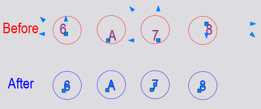

Thank you for your time. The code works perfectly.
I didn't think the code could be very complicated...
I really appreciate your help!
Is it possible to select multiple circles and texts using a frame?
But there is no urgent need for this, just to speed up the process...

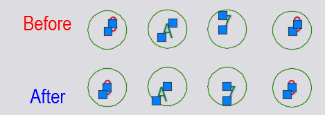

For those who will use this code, there is a small warning.
I noticed a small problem, some mtexts need to be formatted in advance,
this is a bit inconvenient, since we can't see which mtext is problematic,
otherwise, the mtext is converted to text, aligned, but looks like this:

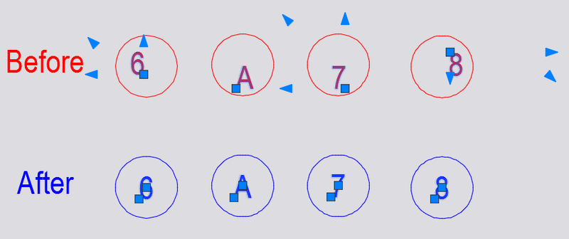

  On 2/8/2025 at 5:11 PM, Lee Mac said:
A similar program can be found here - just change POINT to CIRCLE.
Expand
Thanks for the link, it's very convenient that you can select several objects with a frame, but the code only works with texts that have a "middle-center" alignment. It does not work with the mtext and does not change the alignment to the "middle".
;; Text 2 Point - Lee Mac 2012
;; Prompts for a selection of Text and Point entities and moves
;; each Text entity to the nearest (2D distance) Point entity in the set.
;; https://www.cadtutor.net/forum/topic/37515-moving-text-block-to-adjacent-point/#comment-306285
;; Retains existing Text elevation.
;; Binding the center of the text to the center of the circle
Edited by Nikon
Define 'problematic MTEXT', please
Expand
How Define? What do I need to do?
Texts with "crooked" formatting:
Edited by Nikon

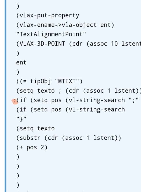

Simply: replace, in the function 'obj->txMC', '(cdr (assoc 1 lstent))' with...
(if (setq pos (vl-string-search ";" (cdr (assoc 1 lstent))))
				     (setq texto
					    (substr (cdr (assoc 1 lstent))
						    (+ pos 2)
		       (substr texto 1 pos)
		       texto
Important: the case of MTEXTs on several lines is NOT contemplated in the code
That is to say: the code will only work well with MTEXTs that contain all their text on a single line
  • Thanks 1

I must be doing something wrong...
; error: syntax error
command: ALIGNTXTTOCIRCLE-GL1
OBJ->TXMC

 (vl-cmdf "_move" textObj "" (cdr (assoc 11 (entget textObj))) (cdr (assoc 10 (entget circle))))
Delete that semicolon
  • Thanks 1
Expand
My carelessness, I'm sorry. It's all right now. Thanks!
Expand
The code is not made to order; it is a starting point from which you can learn and modify it to suit your requirements.
  • Thanks 1
Expand
I don't think I can handle it...😉
